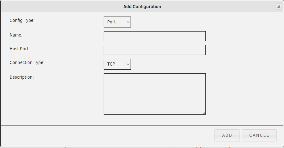

2. Why do i only see "Host Port" when setting up ports for my docker? (See Picture)
Something's not right there.  What version of unRaid?
Version 6.6.1
Docker Compose (it uses .yaml files) is basically a text only GUI for docker containers.  IMO dockerMan (unRaid) is far better.
As stated above. Version 6.6.1, but i figured out, if i edit the docker container in "bridged" mode. it works. As soon as i enter the custom docker network "myProxyNetwork"  the container port disappears.
