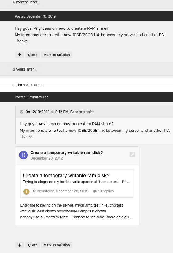

Hey guys! Any ideas on how to create a RAM share?
My intentions are to test a new 10GB/20GB link between my server and another PC.
Thanks
Thanks
Holy necro batman!
3 YEARS later? And a reply with only a quoted 10 year old post?
This has to be some kind of record.
