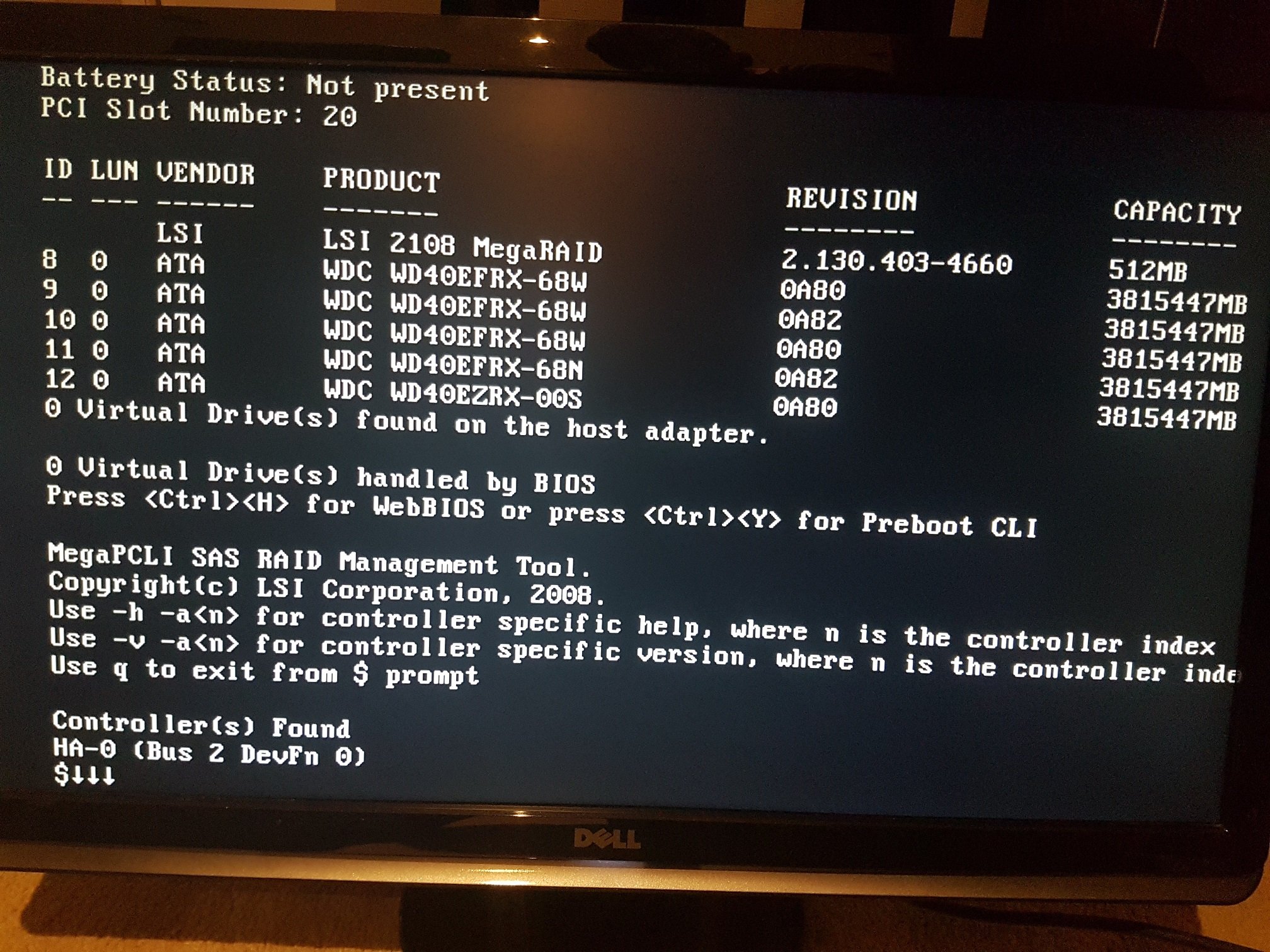

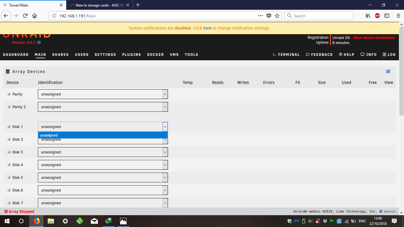

October 22, 20187 yr Bought a supermicro refurb server from ebay. I honestly thought it would be plug and play really. But unraid will not detect disks and allow me to assign them. Pretty sure it's down to the controller card but not sure. The AOC-SAS2LP is down on compatible list. During boot up it shows the disks are connected. Went through the card configuration and cleared any config just incase but still not visible when in unraid. Did post in general forum but seems this is more of a specific question. Are any other steps required when using a controller card? Do I need to flash this and have it running in IT mode? All my drives are no back safely in my trusty HP N40L and have some spare disks and a USB to help configure the Supermicro server now. Any help would be great. Sent from my SM-G930F using Tapatalk

October 22, 20187 yr Author Moved the card to another slot, made sure everything is seated correctly. New test USB with unraid on. New diagnostic attached, but still getting no drives showing. The controller card is working because it detects all the drives in the webBios and you can create raid array using the megaraid configuration wizard. For some reason when its coming to unraid nothing available other than the flash drive. tower-diagnostics-20181022-0503.zip
October 22, 20187 yr 11 minutes ago, bally12345 said: The controller card is working because it detects all the drives in the webBios and you can create raid array using the megaraid configuration wizard. That bios if for an LSI, not a SAS2LP, still no SAS2LP detected, the LSI disks won't show up in Unraid since that's a RAID controller, not an HBA as recommended, for them to show up you need to create virtual disks, but still not recommended.
October 22, 20187 yr OK, I think I know what's going on, when people refer to a SAS2LP in the forum they usually mean the AOC-SAS2LP-MV8 which is a Marvell based HBA controller, I believe you bough a AOC-SAS2LP-H8iR, which is a RAID LSI SAS2108 based controller, like mentioned RAID controllers are not recommended, you should have bought an LSI HBA instead, still if you create raid0 virtual disks they will show up, but there will be no SMART monitoring and possible issues if you need to replace the controller in the future as disks will be detected with a different identifier.
