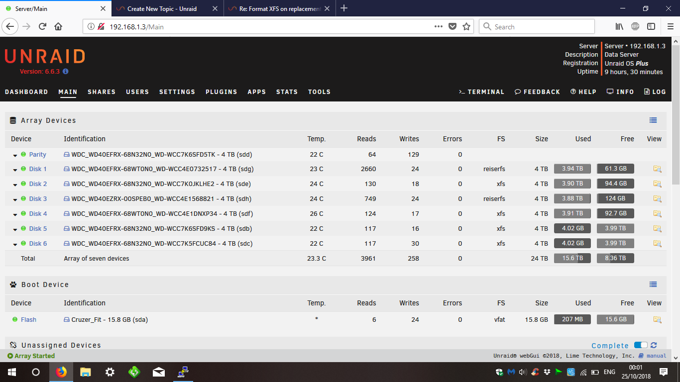

I have no idea how long it will take but im hoping to have it start overnight... I have included a screenshot for reference just incase I have made any errors above.
Just looking for confirmation which command to use really and wheter I can do it from terminal window and turn this laptop off.

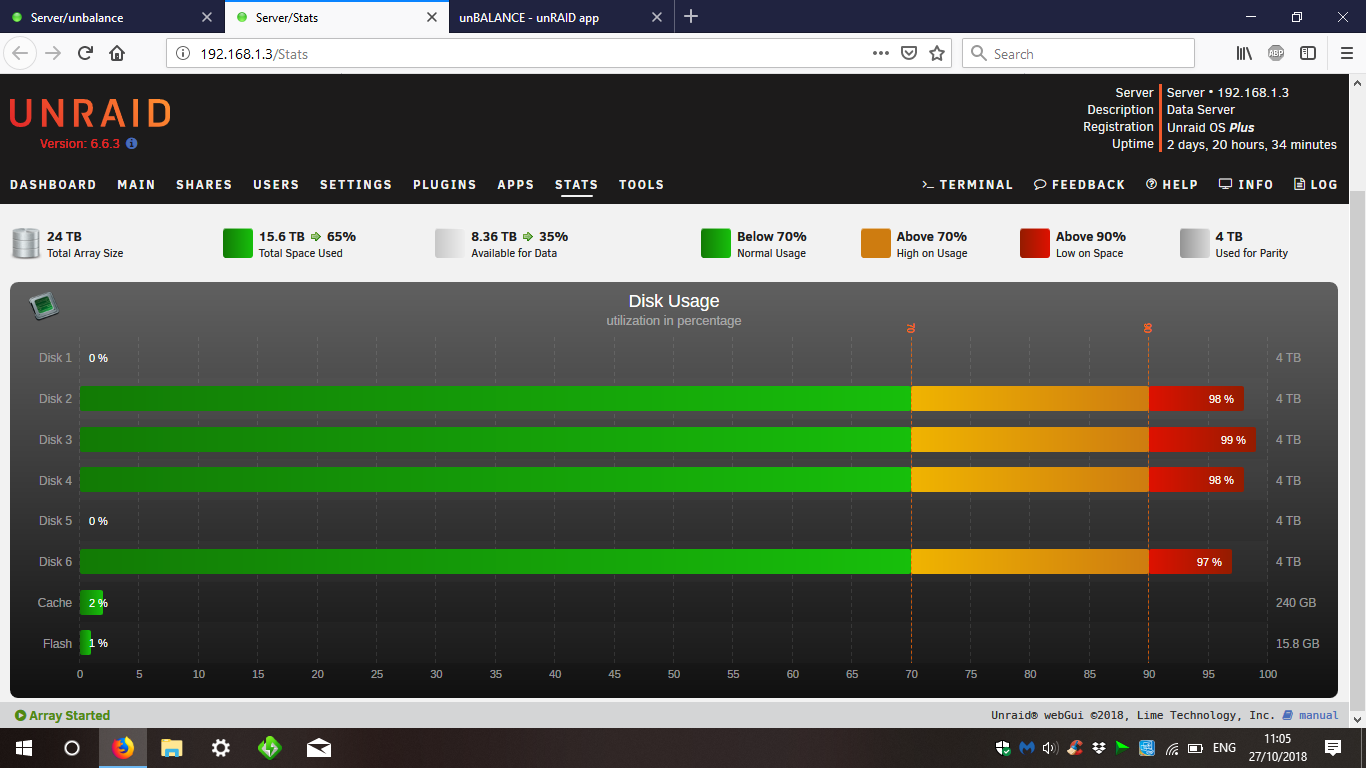

@BRiT could I ask whats the best way to spread my data over all the drives as 4 drives are 90+% full...
1295958004_Screenshot2018-10-2711_05_14.thumb.png.8f7bc2b9d0e3692bf9d55c491c83b6be.png
Or should I leave it as it is and let unraid just do its thing. Ideally I would probably need to make sure thresholds are set correctly and hope unraid just moves stuff itself so im not full to the brim.
Any thoughts?
