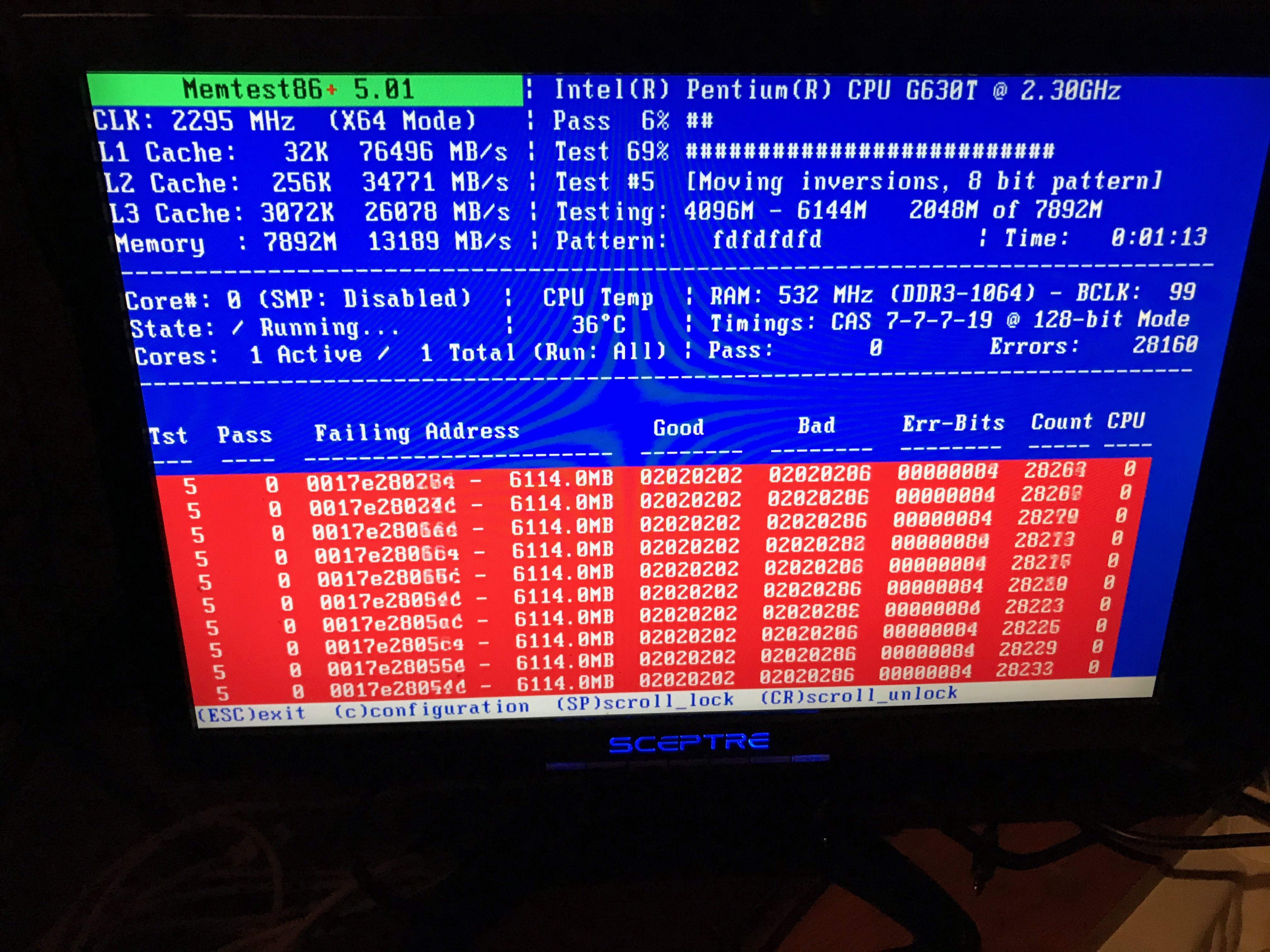

Does this mean I failed the memory test?
Yep, and in a big away, not really surprising considering all the segfaulting, if you have more than 1 DIMM you can test one at a time.
Ok,
It looks like I found the bad stick.  How much of a performance impact would I get if I dropped down to 4gb from 8gb on my server?  Does it matter that I'm dropping from dual channel to single?  It just so happens that I have another couple of sticks of 4gb ddr3.  Should I replace the one still in there?  Add them for a total of 12GB?
Just for basic NAS 4GB is enough, but it might impact your docker performance, depending how many you have, you can try and see.
Dual or single channel not a big difference, it won't be noticeable, use as much RAM as you need for your config.
