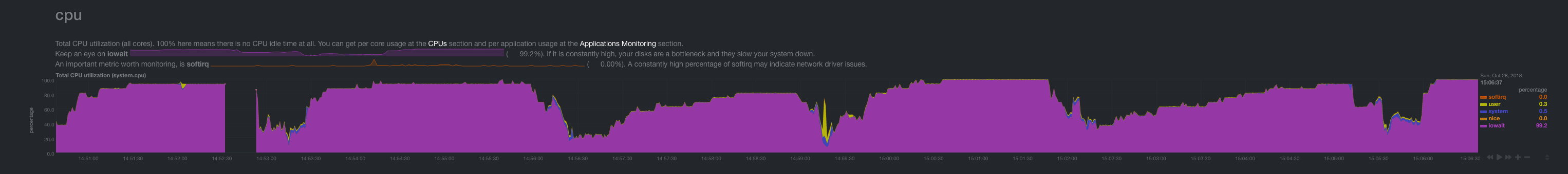

All downloads from NZBGet go directly to the SSD cache (cache option for the share is set to "yes"). I've also attempted to pin NZBGet to the last 4 core & threads with no luck. Netdata is reporting extremely high I/O wait times as seen below:
1552117457_ScreenShot2018-10-28at3_06_38PM.thumb.png.9902b1d1abc7ffe4edcf5822aa41fd3c.png

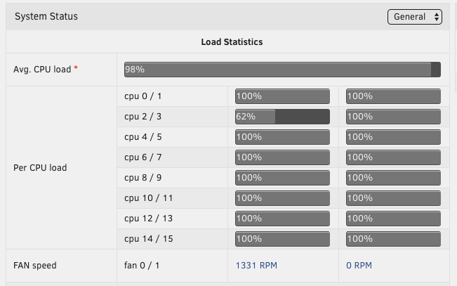

htop is reporting extremely low CPU usage but the dashboard is reporting 100% usage:

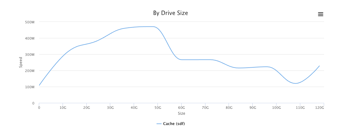

I've got TRIM (dynamix plugin) scheduled to run hourly. A test using "DiskSpeed" reported that the cache drive should be operating normally:
847649499_ScreenShot2018-10-28at4_17_08PM.thumb.png.f0930e1acffbe9bffe606114c97f2720.png
