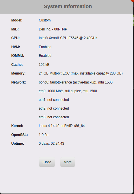

I was looking through the 'Fix Common Problems' plugin earlier and noticed i had a message saying that my CPU was being pinned at 100% (I'll attach a screenshot below).  When I go to my dashboard and look where it shows 'Avg. CPU load' it seems to be normal. On idle it sits on a low percentage and when a Plex stream starts it shoots up to 20% or so.
How do I fix this or is this just a false alarm? I tried to do a search on here but didn't find anything.

By 100% it means that the frequency of the CPU will not throttle down.  Its more of a warning type thing than anything to particularly worry excessively about.  (And there are circumstances where it may also be a false positive)
