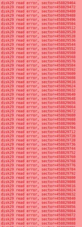

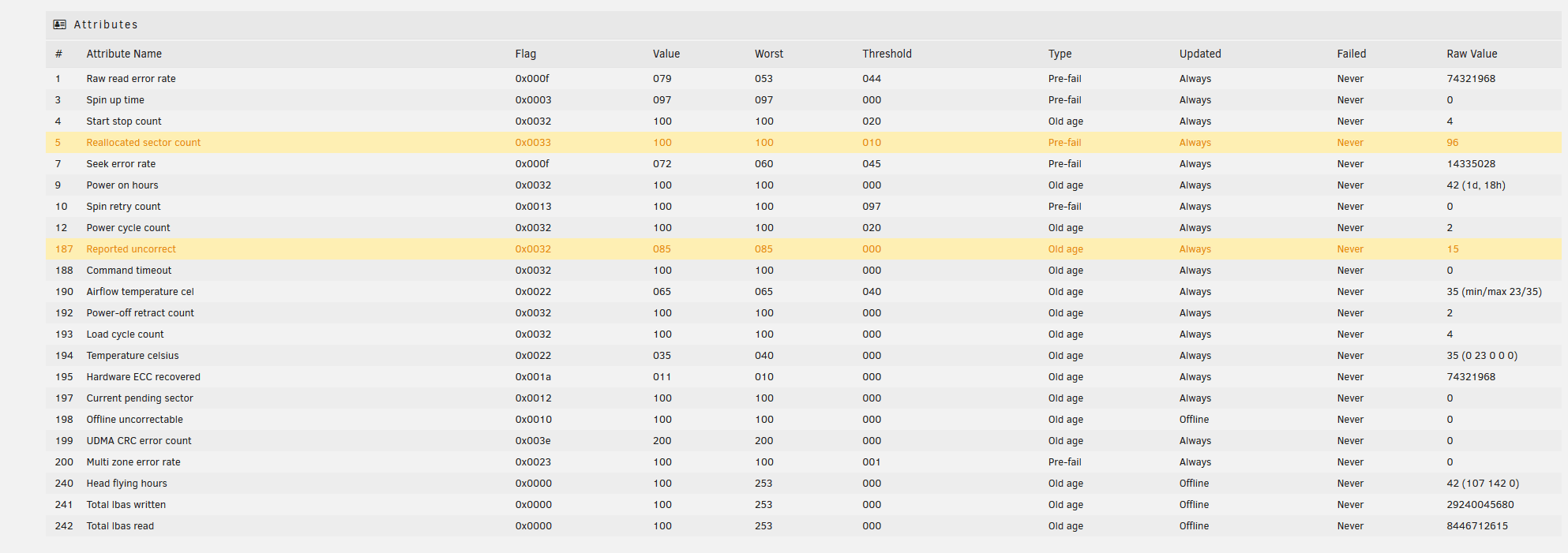

i just add a second parity drive (new) and i receive alert by unraid server
And please find the status file
should i replace the drive asap? i just bought it to amazon.
Thanks in advance,
Regards

Based on the sparse bit that you have posted, the drive is going bad and should be replaced.
