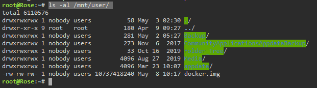

I think you need to get down to the linux level and have a look at the file ownership and permissions.  Start by opening the Terminal in the GUI.  enter this line:
ls -al /mnt/user/
You should see something like this:
Now start down the directory tree by entering the name (Case sensitive!!!)  of one your shares as shown here:
(Note that there is a command line editor in the BASH shell so experiment with the arrow keys!)  This is typical of of the owner/group and permissions that you should be finding.  The 'd' in the first bit of the permissions indicates that it is a directory and the 'x' bit (execute) must be set for directories for things to function correctly.  (The '-' indicates that it is a file.)  Be sure that you check the files that are not working.  Do that copy on a non-working file that you were talking about and see if there are differences.

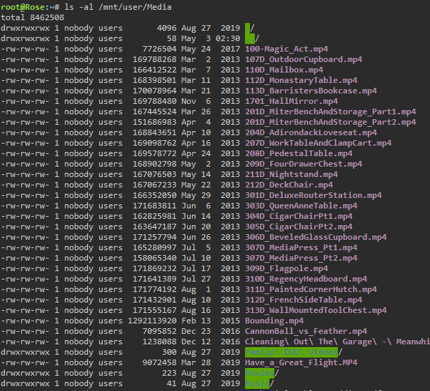

So here's what I'm getting out of that(I used PuTTY, hopefully there's not some obscure reason why that would matter). I removed the dates and file sizes, and changed the file names to simplify things a bit.
-rw-rw-rw- 1 nobody users         file1.mp4 (on Share1, copied into place with Krusader, plays fine in VLC and other players)
-rw-rw-rw- 1 nobody users         file2.mp4 (on Share2, also copied into place with Krusader, doesn't play in VLC but plays fine in other players)
-rw-rw-rw- 1 daniel users           file2 - copy.mp4 (on Share2, copy/pasted in Windows Explorer, plays fine in VLC and other players)
drwxrwxrwx 1 nobody users     Share1(root folder of share for file1, file is at root of directory)
drwxrwxrwx 1 nobody users     Share2(root folder of share for file2 and its copy, files are at root of directory)
As fare as I can tell, the permissions for the files that play in VLC are the same as the ones that don't, with the exception of the files that are copied in Windows are "daniel" instead of "nobody". I assume that's because I created a user "daniel" in Unraid, and assigned that user read-write permissions on every share. That user name and password is what I initially fed to Windows when I first attempted to access the network shares after setup of the server. Running the Safe New Perms tool does change the copy from "daniel" to "nobody". The copy still plays fine in VLC either way, while the original still will not.
For fun, I also changed the owner of file2.mp4 from "nobody" to "daniel". Same results, file still won't play in VLC.
*EDIT* Forgot to point out, I did obviously check the permissions on other files in other shares, both ones that play in VLC and ones that don't. I found no inconsistencies in the permissions.
