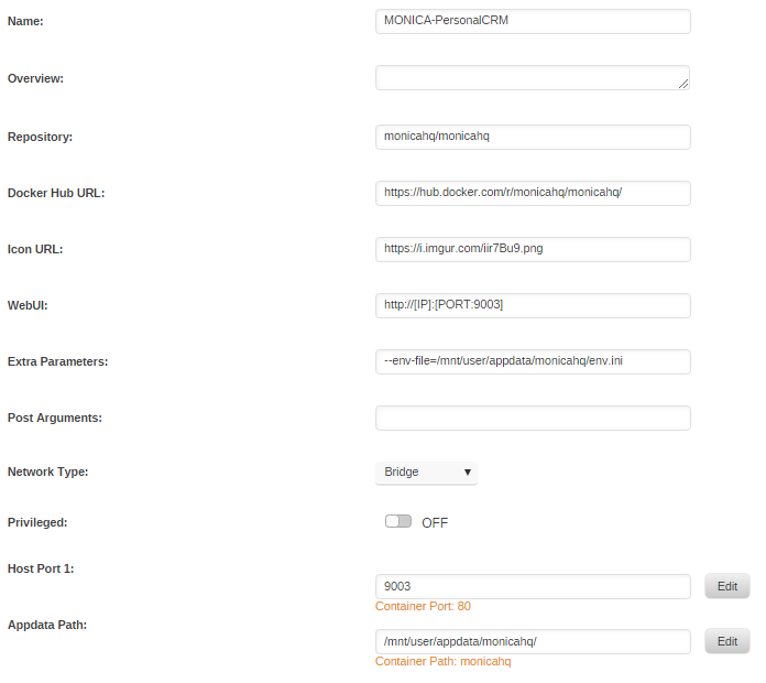

November 8, 20188 yr Author Ok! Question for you. I spun up the database, made monicahq database, and spun up the docker. When I launch the web interface I get the following error: Whoops! Something went wrong. The stream or file "/var/www/monica/storage/logs/laravel-2018-11-08.log" could not be opened: failed to open stream: Permission denied Back to homepage My docker config looks like this: And the Access Mode for the container path remap is "Read/Write". (I tried RW/Slave as well.) (I figured manually creating the folder might be skewing the permissions, so I tried letting the unRAID docker setup create the directory, then placing the env file in, but that didn't change anything.) Any guidance?
November 8, 20188 yr Community Expert 2 things to try: Create the folder in midnight commander (unraid main console, then mc), navigate to the appdata folder and create folder via mkdir (F7) File should be .env not env.ini, what you've done is probably ok, but mine is named simply .env
