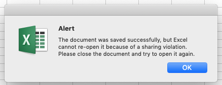

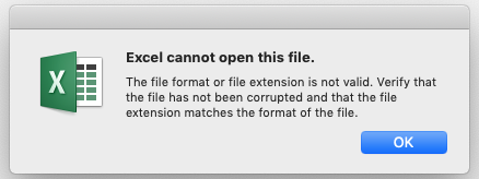

I've recently upgraded my iMac to Mojave and also upgraded my server to 6.6.3 and I've noticed that my excel and word files corrupt during a file save. I created a test share and noticed that when 'Enhanced OS X interoperability' is not ticked, the system is stable. With the option ticked I get error messages and the file size drops to zero bytes. Sample error messages attached. I'm using SMB as I heard it's more reliable/compatible than AFP.
Any suggestions?
