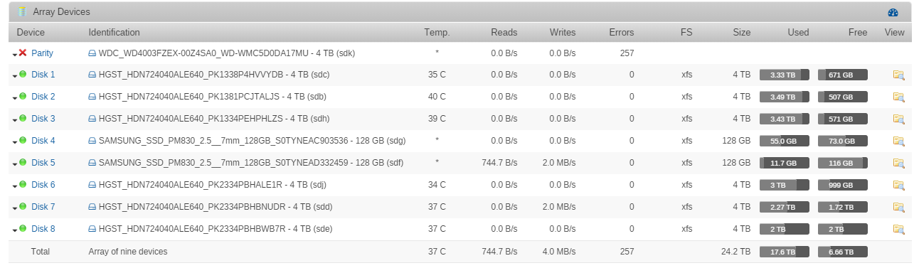

So I faced this issue a few days ago, when unraid showed Parity disk as FAULTY. I removed it from the array, started the array without parity, stooped again and added Parity. It took some time to rebuild parity and everything was working fine until today it happened again. Seems like this time, I cannot do the same. Here's the log of my Parity disk, please let me know if I have to post some other logs/stats too.
Please check attached image also.

Please post your diagnostics: Tools -> Diagnostics
Diags are right after rebooting, but disk looks fine, replace cables and try again.
Yea I rebooted and now it is working fine. Building parity again. But this sure isn't cable problem. Because last time it happened, I was using an HBA and now I've changed everything and all my drives are connected directly to the motherboard.
I can tell you that parity drive runs on little higher temps as compared to the others, and I don't know which drives makes sound but I can hear the random read/write sound when something is running. Do you still think it is normal? I mean why is it happening again and again?
And thanks alot for taking time to check the logs and reply back.
No, it's not normal, and if it continues to happen to the same disk even when used with a different controller and cables then it's likely a disk problem despite the healthy looking SMART.
Alright, thanks a lot for you help sire.
