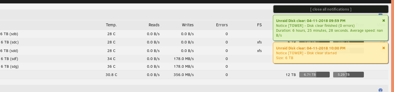

I've just brought a new two hard drives and added them to my array(of two disks and one parity drives), unfortunately, I've had a power loss that resulted in a sudden shutdown during the disk cleaning process(by unraid and not the preclear plugin !)
I've started the server again and everything is fine and I've currently started cleaning process again(every VM and docker was off so nothing was being written to the array, except for the new drives) so even parity check wasn't needed,
should  I be worried about anything ?
this image is after the power failure

so I thought that the hard drives could get damaged if they had a power loss during a read/write sequence because the head won't park, but according to this comment, it seems it's the opposite.
Assuming of course that the BIOS is set to stay off when power resumes after a failure. (which IMO it should)
yes, it is configured to stay off after a power loss
