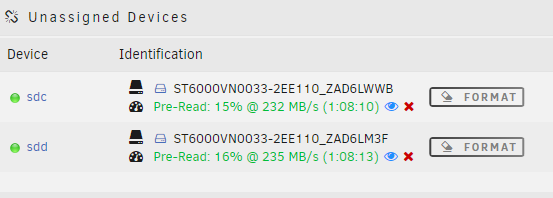

But well for now alot of waiting while preclear runs on my new disks.
