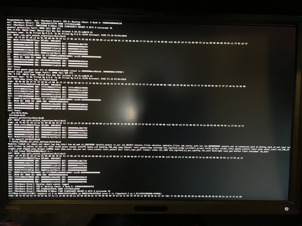

Hi All, I've been using unraid for a few months and so far it has been brilliant. However, over the past two weeks my server is dying almost every night, I won't be able to access the webgui, the console will show the attached errors and all the VMs/Dockers will be frozen. Only a hard restart will bring it back up. I've also noticed that when the server enters this hung state it will be constantly pinging the network and seems to block the rest of the users on the network from accessing the internet.
System Details:
i7-8700k
AsRock Z370 Extreme4
GTX-1050
Additional PCIe USB3 controller
The system is stable, I've done 4k video trans-codes over 8+ hours using Handbrake without any issues and prior to installing Unraid I had windows on it with a whole bunch o stability tests. Due to the nature of the problem the attached screenshot is the best I can do with logging the fault, I've included a syslog as well but I don't know if that will include the error. If there is another way to log the issue please let me know and I will get it!
Thanks.
gargantubrain-diagnostics-20181105-1538.zip
I would using the Tips & Tweaks plugin install MCELOG (you've got a machine check error).  Then from Fix Common Problems, set it to run every hour, and put it into Troubleshooting Mode.
Maybe it will catch the error.
You might want to also run a memtest for ~24hours to see if its the memory causing the issue.

My server managed to go a few days without the error but it came up tonight and I think Fix Common Problems caught it in the attached logs. Could this be the issue here?
