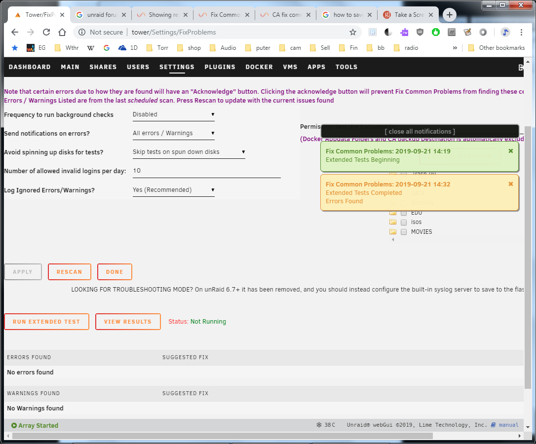

I have same question.  Where is the log for extended test using Fix Common Problems?
I ran extended test, and little yellow notification box in the top right of screen says "errors found", but the bottom of screen shows "No errors found" and shows "No warnings found"  (see screenshot attached).  So I do not know if I have errors or not.
Click view results
Sent from my NSA monitored device
Of course.  How dumb of me.  I did search out and find that button when it was grayed out while the test was running.  Then when test was done I forgot about it could change and check again.
The "View results" button gave me a page of data, like a log file.  It showed what seems like a few minor problems (probably not too important).  Is it because they were not important that the screenshot bottom showed "no errors" and "no warnings" ?
The bottom is the results from regular scans
