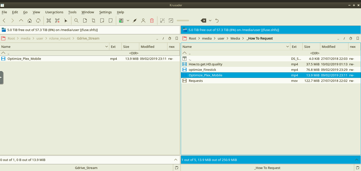

after I mount it, I open Krusader, Navigate to /mnt/user/rclone_mount/Gdrive_Backup . and move a file there and it just copies there locally
Yeah the mount didn't work, otherwise you would see 1 PiB in Krusader.
