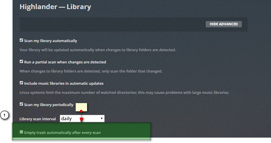

and depending on how you've got plex setup, it will either (i) delete the reference to the /normal/folder/movie or (ii) say /normal/folder/movie is missing and delete it when you empty trash.
I prefer the 2nd way, because if I've made any changes to the metadata (labels, posters etc) they are preserved whereas the first way ditches all custom edits and redownloads Plex's metadata.
Edit:  the 2nd way is also advisable because if the mount ever fails, plex won't delete the items from its libraries, and then re-add them
Edited by DZMM
Where exactly i can change these options?
"empty trash automatically after every scan" in Plex library settings
I cant find that exact option, the best i found i would translate into remove old packets weekly.
Its the second on the "sheduled things" tab.

And thanks for the info about plex, i found the option. If it works i have to test.
