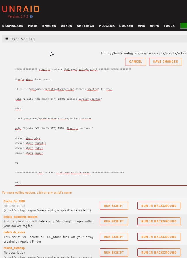

17 minutes ago, DZMM said:
Are you using the user scripts plugin to run the mount script?
Yes

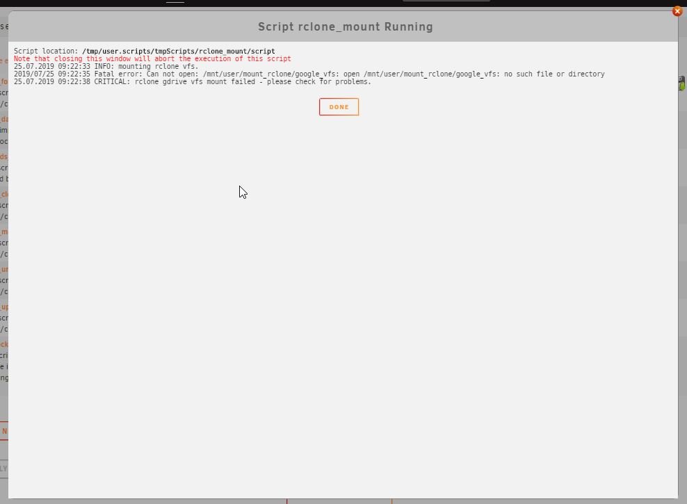

I rebooted, run in the background and I have the same error:
25.07.2019 16:52:39 INFO: mounting rclone vfs.
2019/07/25 16:52:40 Fatal error: Can not open: /mnt/user/mount_rclone/google_vfs: open /mnt/user/mount_rclone/google_vfs: no such file or directory
25.07.2019 16:52:44 CRITICAL: rclone gdrive vfs mount failed - please check for problems.

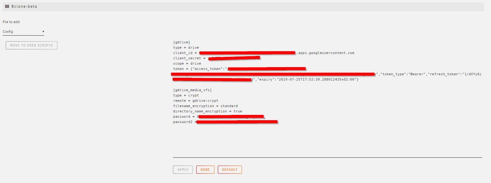

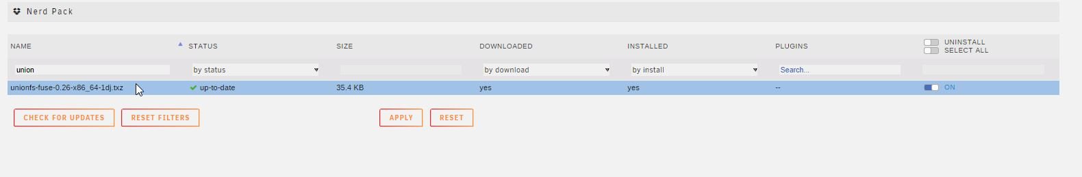

Could you please double check that I am doing it right:
  1. Installed Rclone BETA and add this config:1923298102_2019-07-2516_59_12-Kanard_rclone-beta.thumb.jpg.b8bbe2bd6788c70e0c5ae4e3d60da75d.jpg
  2. Installed Unionfs-Fuse from Nerdpack:4455667_2019-07-2516_58_56-Kanard_NerdPack.thumb.jpg.d3a30a4a9f638b5d219e762c75815384.jpg
  3. Copied all the scripts in userscripts
  4. Past those commands to ssh:
    1. "touch mountcheck"
    2. "rclone copy mountcheck gdrive_media_vfs: -vv --no-traverse"
  5. Started the mountscript in background
1531577641_2019-07-2508_53_43-Kanard_Userscripts.thumb.jpg.ea37cd23e1cfaa3566785b46dfd9f014.jpg
--> Am I missing something? I started everything all over again with the same result...
Thanks !

That usually means the folder wasn't created for some reasons and/or your rclone mount command uses a different path.
There is a mkdir line in the script e.g.:
mkdir -p /mnt/user/mount_rclone/google_vfs
Do you find an mkdir line in your mount script?
Instead of doing screenshot of the scripts, it's better if you copy-paste your script into a post (remember to use the forum's code functionality - the button that looks like </> so it's easier to check).
I use the exact script from github, I posted a code insert of it at the top of this page.

Do you have a /mnt/user/mount_rclone/google_vfs folder?  If not create one.  I think this will solve your problem.
I've added:
to the mount script.  I think there was a reason why it's not there, but I can't remember why so adding until someone tells me it causes a problem.
Edited by DZMM
@DZMM how would your cleanup script work for a mount you've only connected to mount_rclone (backup mount for example which isn't used in mount_unionfs)? I can't alter your script as I'm not 100% sure whether some lines are necessary.
I've added:
This seems to have solved the problem... So trivial ! Thanks :D
