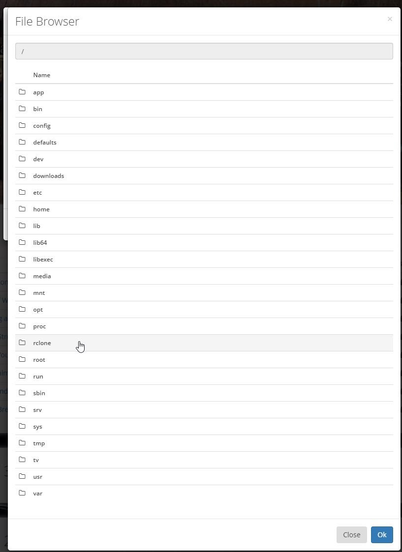

I found a big bug !
If I go to Sonarr to change the path of a tv-show (did not try a movie yet) my mount is gone as soon as I click on the path that I configured in Sonarr:
My previous show was local, I copied everything in the rclone union folder, it uploaded successfully. I went to change the path in Sonarr to point it to the union folder and as soon as I click on it, the mount is gone and the only files I see in the Union folder are the one in the Upload folder.1870682349_2019-07-2921_28_58-VeronicaMars-Sonarr.thumb.jpg.7e48f5a08e9bc7ef9f9086aeb10e0df7.jpg
Edited by yendi
35 minutes ago, yendi said:
I found a big bug !
Have you looked in the rclone_moubt folder?  There's a small delay between files being uploaded and appearing there.
To be honest though it sounds like you've set up your unionfs folder wrong somewhere if you're not seeing any cloud files
I can assure you its a bug; everything is working fine when I reboot: all script launch perfectly and upload is working. Bug when I go to sonarr to change the path of ANY tv show by using the path browser, the "mount_rclone" folder is suddenly empty thus, the Union folder aswell.
If I change path using the bulk editor, the mount is preserved.
When the mount disapears, I tried to unmount + remount and it fails (can not connect to end point) and when I reboot, everything is fine. Can someone try ?
Edited by yendi
Have you tried restarting sonarr?  I change the paths of shows/movies frequently without any problems, both from mount folders to another mount folder and in the past from local-2-mount and vice versa
Well, not it seems to be working correctly. The only thing I changed is disabling a plugin (Unbalance) and restarting the server.
I try to browse an other show and it seems to work perfectly 🤷‍♂️
