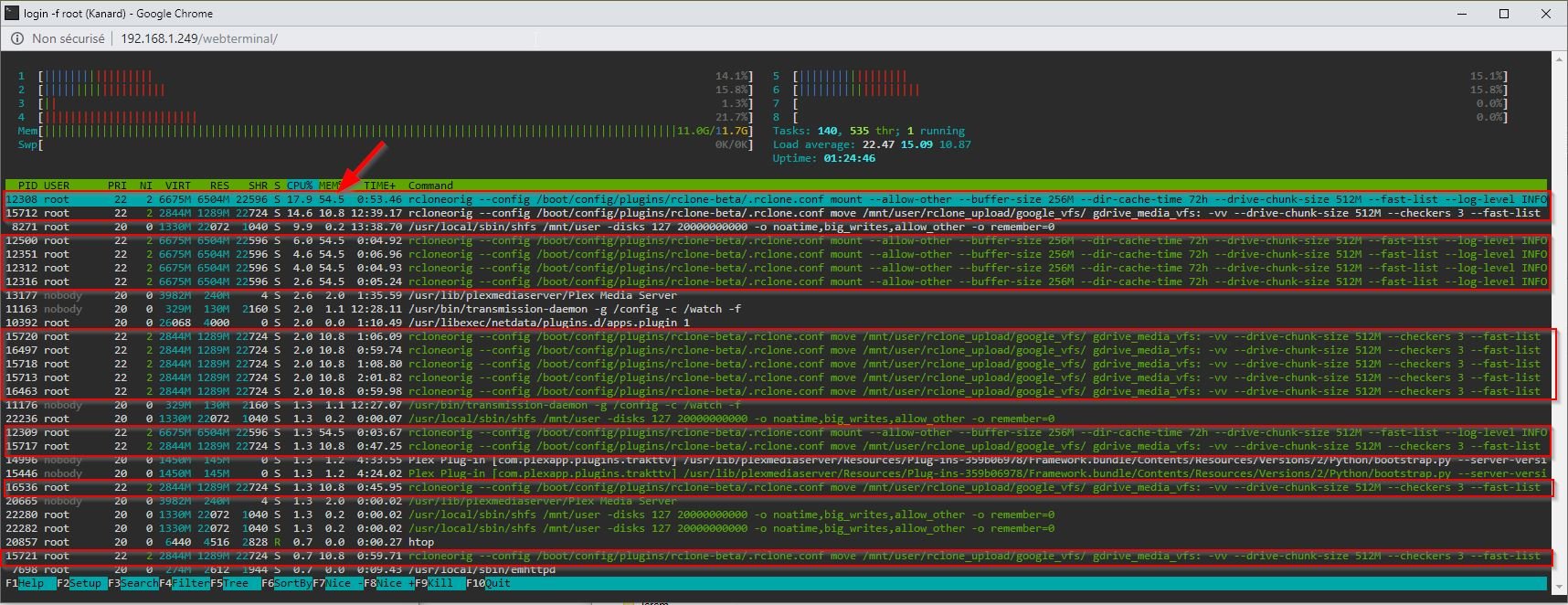

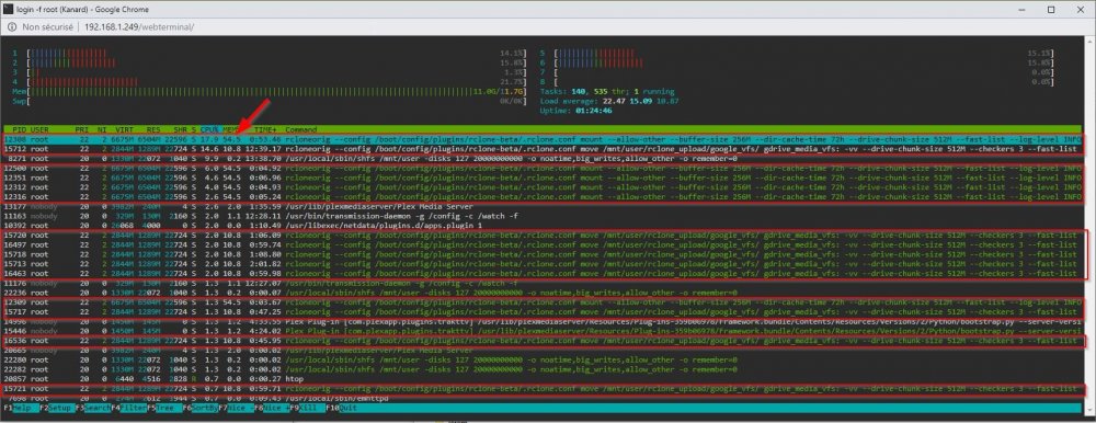

I think there is an issue with Rclone: I saw in live the dismount issue and saw this:
rclone had multiple processes using 100% of available memory. Then it crashes and I have to use the unmount script before the being able to remount.

Is there any possible explanation?
Thanks

So with the help of rclone guys I might have found the issue:
I have 12 gb of ram and when I upload + all the services running on unRAID i am using about 8.5 of the ram.
When Plex is doing the thumbnails it seems that it consume all remaining ram for the job: it consume some ram for Plex itself + the --buffer-size 256 * number of opened files. Apparently its 4-5 files simultaneously.
I lowered the buffer-size variable to 128mb and I have not seen the issue since 24h.
Hope it helps someone who would face this issue !
