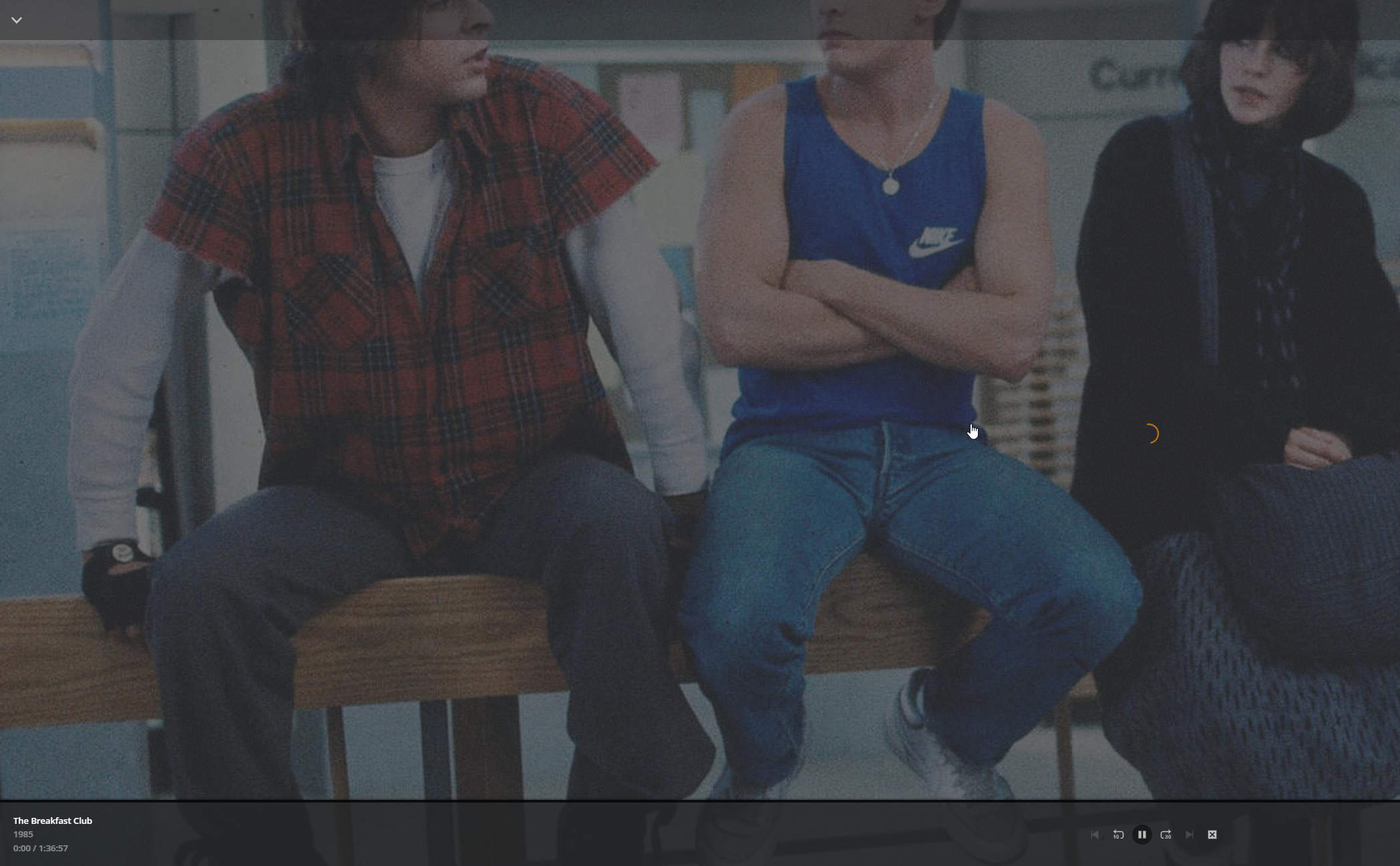

Here is what I have on plex when I try to start a remote movie: image.thumb.png.a026e907e97e42cfccddd0798fca5b2c.png
I tried to create a new plex docker to do some tests (plex inc provider this time instead of linuxserver), here is my findings:
I created 2 libraries: One pointing on rclone_upload (so all the pending uploads) and an other on the mount_rclone (so all the already uploaded files).
Plex can parse both folders, local and remote and find the correct info from the media (Resolution, subtitles available etc) but is still unable to play remote content...
I dont understand how it can get metadata and file info and not be able to open the media...
Crazy thing is that I am able _sometimes_ to open a remote file, I would say 10% of the time.

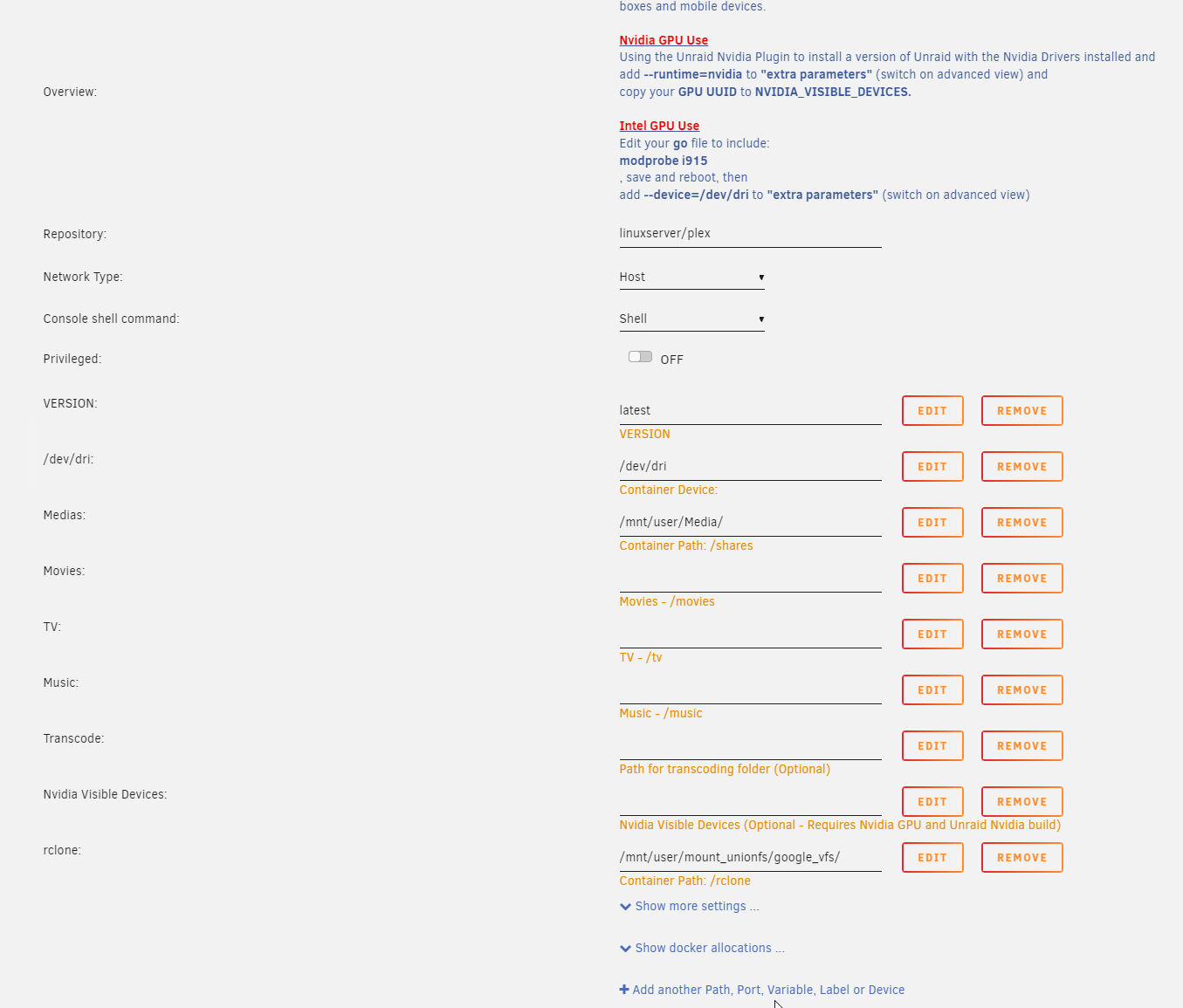

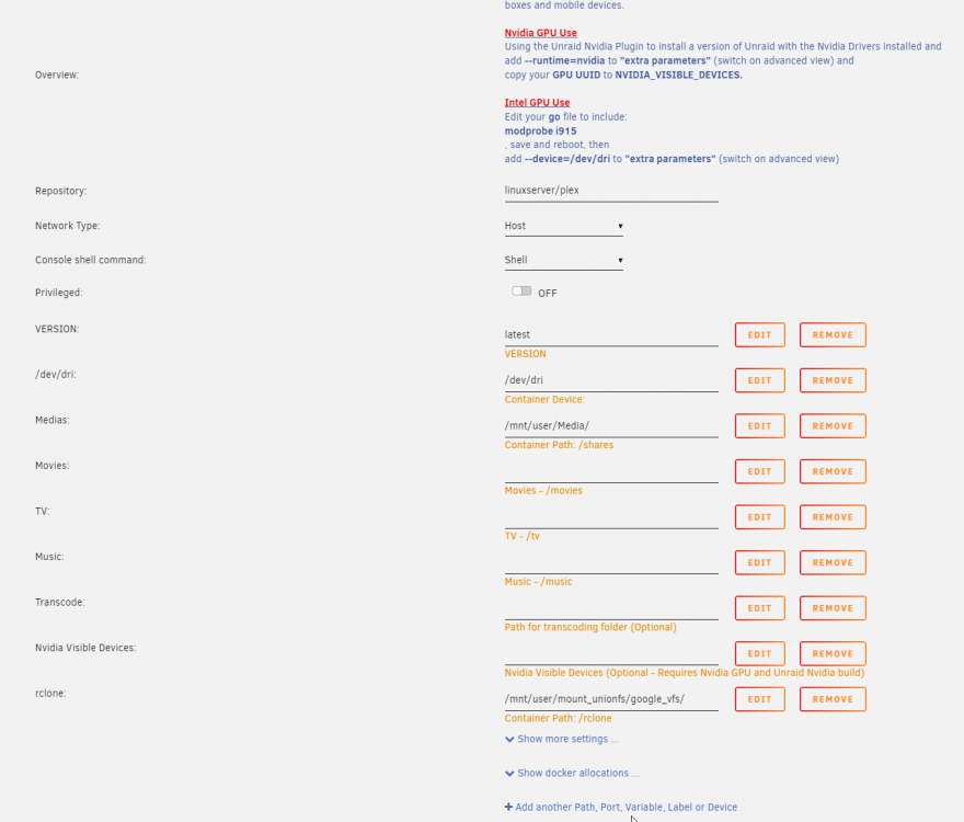

@yendican you post a screenshot of your Plex docker settings? Did you put the right folders as r/w slave? And what folders did you add to your Plex library? Did you disable all the analyzing stuff?
Regarding the R/W I restored the "Safe Docker Permissions" but did not touch anything else. Maybe it could be the folder where the temporary movie is downloaded that has RW issues? I mean Rclone must be storing chunks somewhere when playing a media, maybe he is not able to do so ? Do you guys know where it could be ?
Rclone stores it in your RAM, so that shouldn't be the R/W issue. I don't understand why you have that /dev/dri in your Plex template? I don't have it, so it's something you've added manually?
Also why didn't you fill in the links to Movies and such? They should be pointing to your unionfs/Movies folder with r/w access.
The dev/dri is for hardware acceleration. Regarding the /Movies and /TV i use an other variable the /rclone one that you can see at the bottom of the screenshot...
Try running Plex vanilla. So without the hardware acceleration and see if it runs then. Are you sure your Plex library is pointing to the right level of folder? When you go into your Plex library and you open a movie (not play it) do you see that everything is filled in correctly? And the linking is correct to the right folder and file?
For the folder mapping, yes I am sure it is mapped correctly and plex SEE the file (it can analyse it and see subs included).
Regarding Hardware transcoding, no luck, I just tried to deactivate and some media are playing, other not (remote). Crazy thing is that the same media is playing remotely with no issue and an other one is not. But I am able to open all media on a windows computer so it is not media related...
Ok, so where do we stand now? Opening files through windows explorer all works? They all play? And only Plex now gives problems with sometimes playing and sometimes not?
