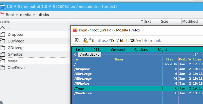

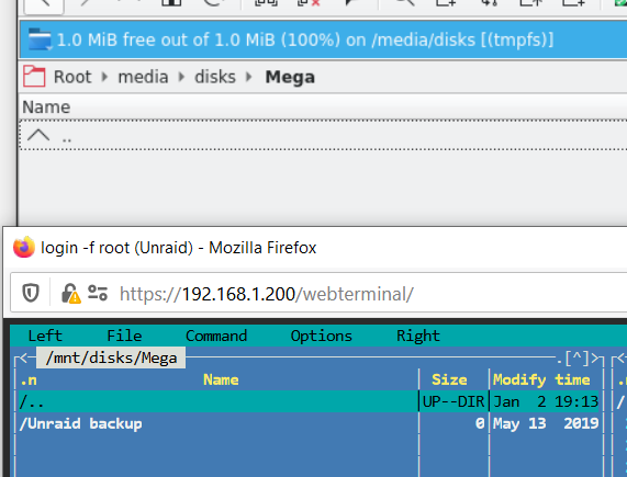

Proabably a noob question but I have a little problem I can't resolve.
I have followed this video
And everything is fine until I try to see the files with Krusader, I can see the contents with "mc" in command line but not with Kusader
Why is this? how can I fix it? in Krusader /mnt/ is mounted as /Media.
EDIT: IN CASE SOMEONE ELSE HAS THIS PROBLEM HERE IS THE SOLUTION
Edited by L0rdRaiden
