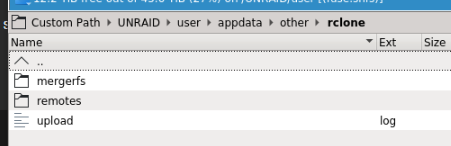

Check the aubfolders
mergerfs: empty
remotes/gdrive_vsf: "dockers_started" and "upload_running_daily_upload"
Just now, faulksy said:
mergerfs: empty
Yeah upload running is the checker file for uploads. Delete it and you should be able to upload

Go to that upload.log file it should show what is happening. It's in appdata other rclonr
It goes to add things and then deletes
