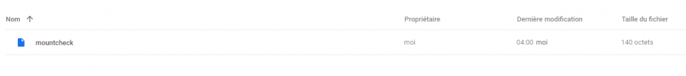

no I miss this part i think.
But can you explain me a bit what i need to do in the gdrive i don't really understand this part. (I just read it )
Edit:
I create a file in my drive  with the commands inside
touch mountcheck
rclone copy mountcheck gdrive_media_vfs: -vv --no-traverse
rclone copy mountcheck tdrive_media_vfs: -vv --no-traverse
Thx
Edited by francrouge

Hi nop
always getting 1
9.12.2018 05:32:57 INFO: mounting rclone vfs.
2018/12/19 05:32:57 NOTICE: Serving remote control on http://127.0.0.1:5572/
19.12.2018 05:33:07 CRITICAL: rclone gdrive vfs mount failed - please check for problems.
Script Finished Wed, 19 Dec 2018 05:33:07 -0500
I'm not using teamdrive so i just copy the mount code i thought  i needed
Did you create the mountcheck file?
touch mountcheck
touch mountcheckrclone copy mountcheck gdrive_media_vfs: -vv --no-traverse
Yes but i just realise that i created the file on my windows pc and transfert it directly to my gdrive.. so i don't think its ok lol
I'm going to redo that
touch mountcheck
Hi so i manage to run the commands
In the logs everything look good.
But My concern is this.
I just want to be able to drag movies etc in my gdrive and then play it with plex.
So how does you're script works ?
Because ive been reading it and i don't quite understand  the union_fs part.
I can create my folder there but can i dump my files there ?
Because nothing is showing up in gdrive write now ?
thx  a lot
