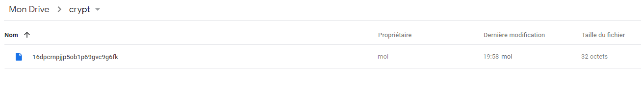

Hi again If i tried to do the mountcheck i got an encrypted file in gdrive but if i put a file directly via krusader i got nothing.
What should i do ?
thx
What should i do ?
thx
use the commands via ssh to create the mountcheck file and to transfer it's foolproof.
If you're not seeing your other files then something's gone wrong with your encryption - are you sure the new vfs mount is using the same keys as your old encrypted mount?

Hmm.  everything looks correct.  Apologies if these questions seem obvious:
1. Are you definitely using the right password and password2?
2. the files that are already in gdrive are encrypted (goobledegook when you look in google)?
3. Are the google files in a folder called crypt on google i.e. not encrypted so you can see my drive/crypt when you look at Google?
It's ok lol maybe i made an error somewhere.
1. Password is ok just tested
2. the mouncheck file is encrypted so i suppose its working.
3.yes i can see it
Check my picture just in case.
Inside mountcheck it should look like this ?
touch mountcheck
rclone copy mountcheck gdrive_media_vfs: -vv --no-traverse
thx
Edited by francrouge
3.yes i can see it
touch mountcheck
thx
1. there's nothing in your crypt except your mountcheck file.....
2. you shouldn't be seein the mountcheck file in rclone_upload/google_vfs though as it's already in the cloud.  What does your /mnt/user/mount_rclone/google_vfs look like?
