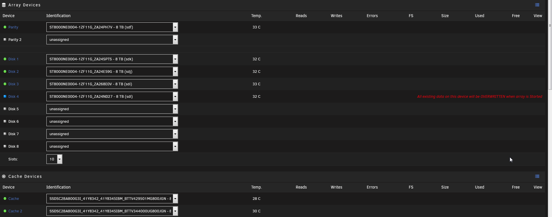

Hello,
My USB device died today. I have a backup from 4/11-2018 i have restored from.
The problem is that the array had 1 parity disk and 4 data disks.
But UNRAID is not accepting the fouth data disk as a valid disk?
How do I correct that? (See attachments)
I know the data on the disk is valid, I just need to tell UNRAID its not a new disk.
Thank you!
DISK_ASSIGNMENTS.txt
-Tools -> New Config -> Retain current configuration: All -> Apply
-disk4 will likely need re-assigning
-check "parity is already valid" and start the array
If you only did what you describe parity should be 100% in sync, but it's not a bad idea to run a parity check.
Thank you very much!
That worked 😀
It can be dangerous to use a backup that has a different disk configuration than your current one. Several people have restored an old backup only to find that an old parity disk which had been moved to a data slot was being treated as parity by the old backup and so its data was getting overwritten with parity.
You can download a zipped copy of flash at any time from Main - Boot Device - Flash - Flash Backup.
