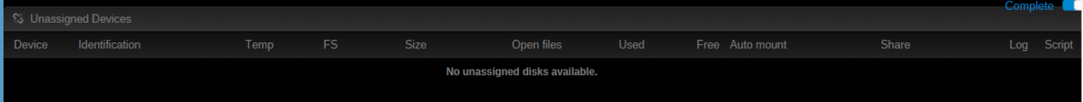

All other Web UI screens are fine and plugins appear to be running, for example unassigned drives is visible under Main.

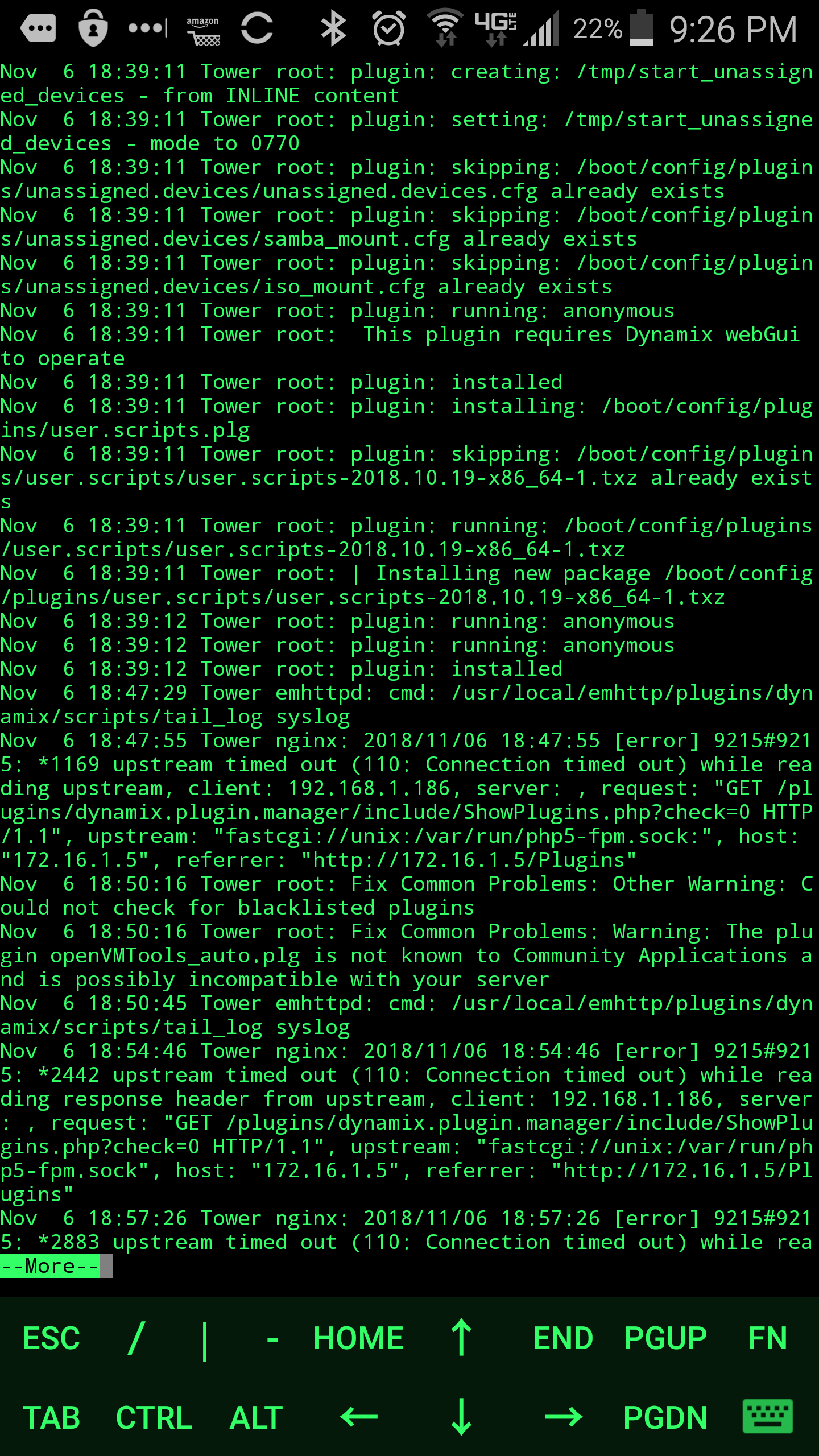

Nothing is jumping out at me when I tail the log:
cat /var/log/syslog | more

Seeing this in my log:
