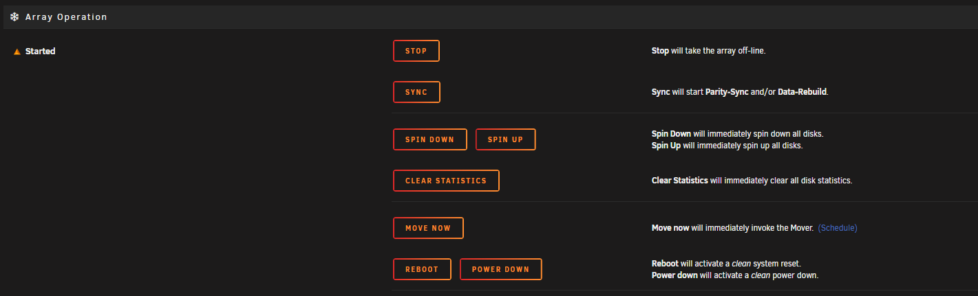

I tried to remove the disk and install spare old disk to rebuild data, the main page now shows as below
 should i start the sync?? will it affect recovered data or data on other disks??
Edited by pg93
Start the sync, data on disk2 will be the same as now
