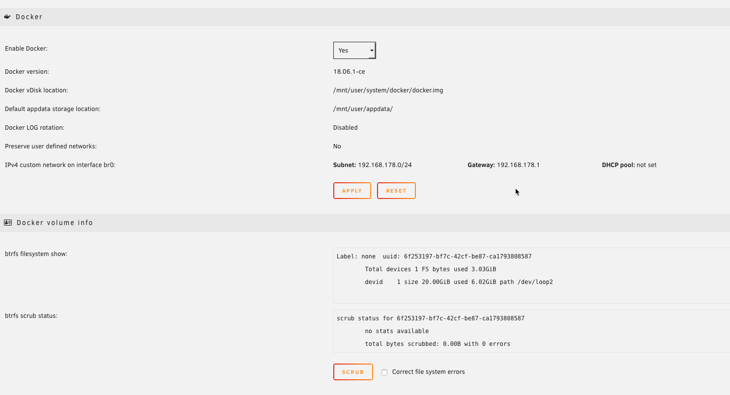

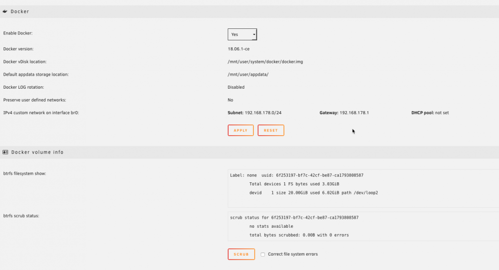

Did you change the default settings under settings > docker settings? (I think it's under settings for the docker engine)?
Edited by whipdancer

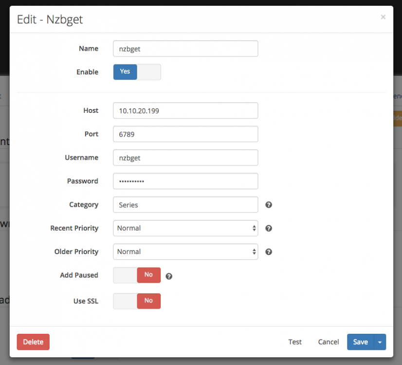

Is there any reason why you need to have the same ip assigned to a container or to connect through hostname each time it starts.
For most purposes you would use the servers ip address and the port which the container is using to access the container.
For example for me nzbget is on port 6789. So to access it i type the ip of my Unraid server (10.10.20.199) the the port
So 10.10.20.199:6789
1902673623_ScreenShot2018-11-08at17_53_19.thumb.png.d1d50642746bab495c01aa75f5947fff.png

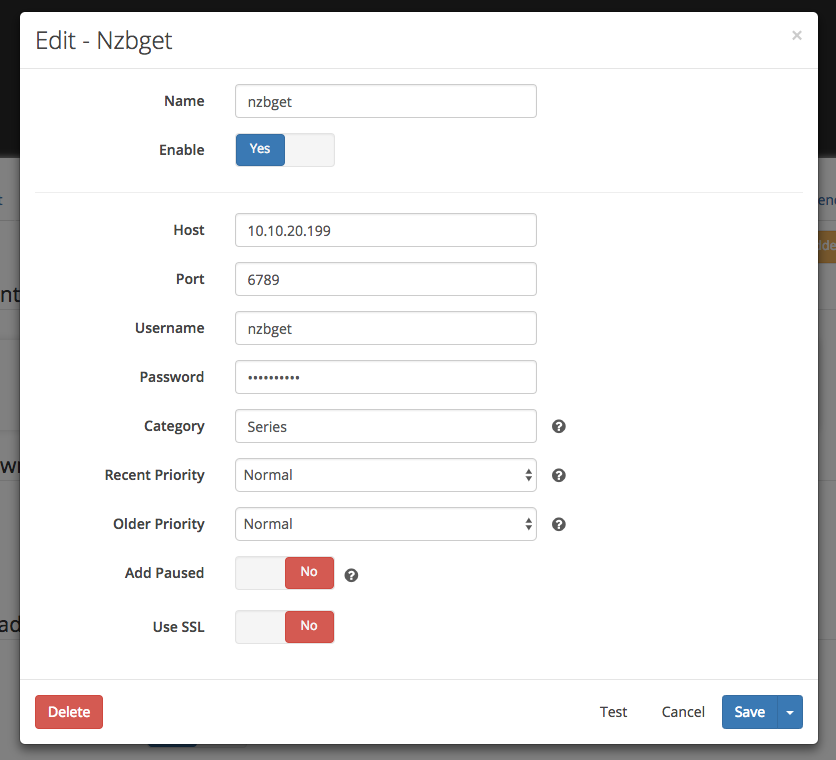

So if i wanted to configure sonarr to talk to nzbget i would tell it to use that ip as that mapping will not change.
855570035_ScreenShot2018-11-08at17_45_52.thumb.png.d98ce87ce3dc3850998e46c408a64f35.png

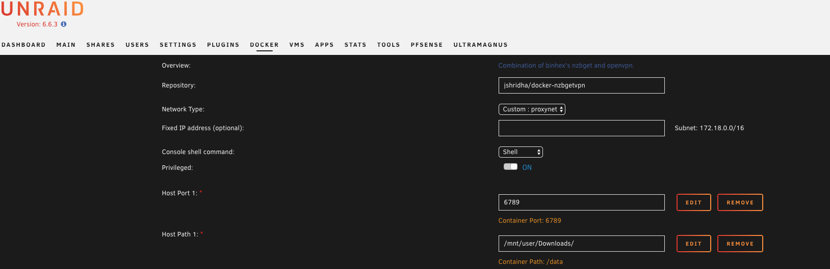

However there may be use cases where by you might want to have containers talk by host name. For example using a reverse proxy
it is easier to use hostnames.
To do this you have to use a custom docker network. I showed how in the video i made on letsencypt reverse proxy here that you may want to check out.
https://youtu.be/I0lhZc25Sro?t=688
