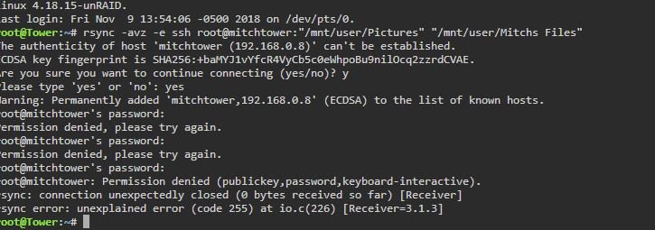

rsync issue was working now ask's password on remote yet no password

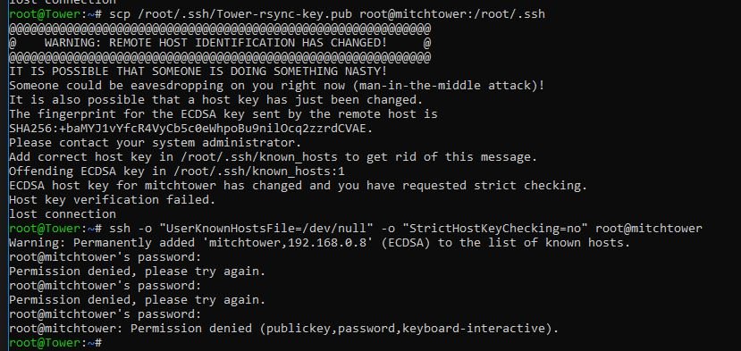

since im guessing because i had deleted the ssh folder  earlier today i getting that tampering error...  is there a way to tell ssh or rsync to reconstruct itself
i looked under settings  under ssh, but there is no option to reconstruct  or uninstall and re install it
i uninstalled and reinstalled  SSH plugin  on both tower and the backup tower  and re ran

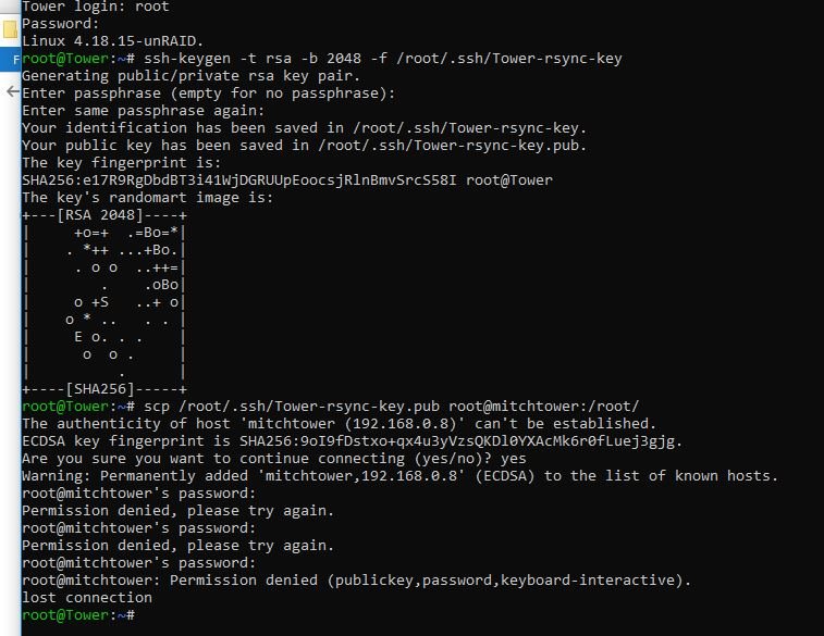

scp /root/.ssh/Tower-rsync-key.pub root@mitchtower:/root/
but im getting that error still  about host file...  is there another command to fix this

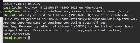

but i re tried  the create  Key and to push to the backup server..   so now i got rid of that tampering thing.. but it keeps asking a password on the backup server  but i dont have a password for the backup unraid  how i fix that?

nope my root user i dont use a password
and when i run
ssh-keygen -t rsa -b 2048 -f /root/.ssh/rsync-key
i then type yes and hit enter    dont use a password..

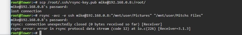

when i create a user mike and i used password i get this error

i tried again to copy that key file over from tower and it connection closes  unraid11.JPG.0a14517e72554e69c750b950bd872593.JPG

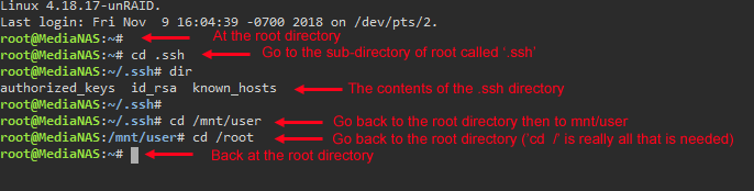

cd root - go to a folder called 'root' that is a sub folder of whatever folder you happen to be in.
cd /root (just 'cd /' is sufficient - go back to the root (very top level of the filesystem) regardless of the folder in which you are currently working
When you start a terminal session from the unRAID GUI you are already at the root.  When working from the command line you are working with the unRAID filesystem in RAM.  This has nothing to do with the flash drive contents unless you navigate to the flash drive directory.
If you want to look at the contents of the flash drive from the command line do a 'cd /boot'
In Windows you are working with the contents of the flash drive (or other exported SMB user shares).  You will NEVER see anything called 'root' when looking at the flash drive or any other shares. When you open the 'flash' folder in Windows, you are at the root of the flash drive, but, there is nothing called root.

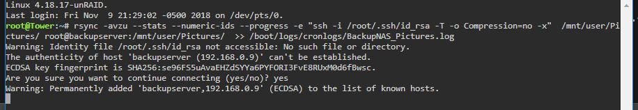

but i made sure no spaces  and ran above  and rebooted and still  problems  cant solve the password issue on the mitchserver gonna reformat that one i guess no one has answer
but here you see the error still and i ran it in the order i posted aboveunraid12.JPG.73061aba57817b5a87460484887e67b7.JPG

ah ok  ya  one miss type and she buggers up... still cant resolve that id_rsa issue and cant resolve the asking for a password on my other unraid computer when it doesn't use a password and since I don't think anyone has an answer for that issue I gotta formate the usb and restart over
Why don't you set a root password, then when you're asked to enter one you can do so?
