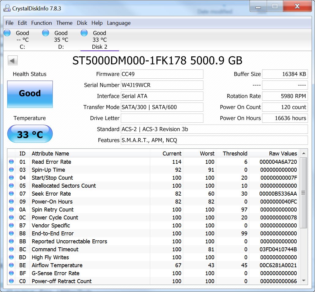

I've seen this happen to others where it ends up being a fluke or a cable that flickered...Received a red X on a drive from the array (~4000 errors in a row), pulled the drive, and have been testing this thing to the max (HDTune full error scan, and Preclear script)...and still nothing really shows wrong with it. Was it a fluke that I can just preclear and put back into the array? Should I trust it? I attached a crystaldiskinfo smart report.
Please post the diagnostics instead, but the disk look fine, at list the partial attributes that appear on the screenshot.
