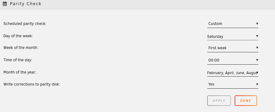

My setting. I setup first Saturday everi 2 month. Parity check not start never on schedule.
I must admit that looks correct.   You might want to see if the entry in /etc/cron.d/root looks correct?

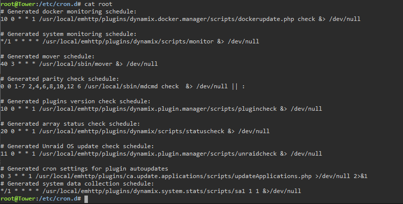

This is my cron.d.
My understanding of the crontab entry the parity check entry is set to run on the 1st to 7th of the month and each Saturday;    It is not the 1st Saturday of the month.

Make a change, any change to the schedule, then revert it.  That looks like the old version of the entry which does not work correctly.

Your entry looks at first glance like it should work, but with your settings my entry reads
# Generated parity check schedule:
0 0 * 2,4,6,8,10,12 6 [[ $(date +%e) -le 7 ]] && /usr/local/sbin/mdcmd check  &> /dev/null || :
which is slightly different to yours.   I am 6.7 rc7 so that may explain the difference, but why it seems to need '*' in the third field and the check for Saturday moved to the executed command I am not sure.  I guess it could be a bug or limitation in the crond daemon?
