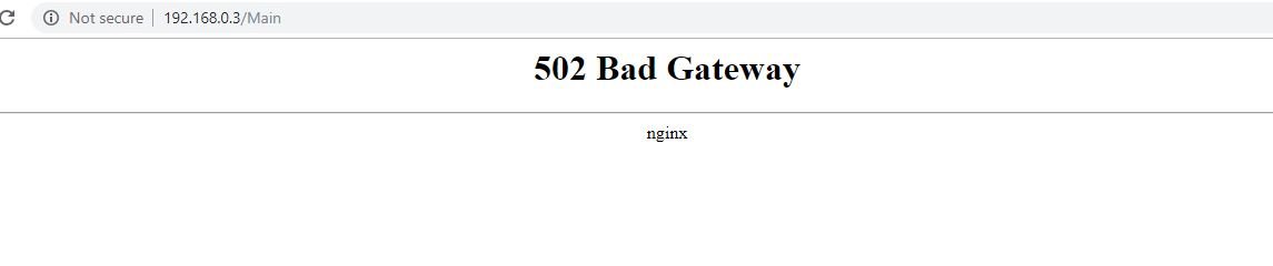

502 bad gateway cant fix
im making a new topic since i not sure if the rsync topic can fix this
i had posted i having lots issues with the rsync  now it said someone tampering and such...  i had uninstalled SSH Plugin  didnt help   i reinstalled it didnt help  i uninstalled it deleted the SSH folder and rebooted  tower
now  when i booted up  i get 502 bad gateway... i can telenet in... and my Plex server still works.. but i cant access gui to reinstall ssh  for rysnc
is there an easy fix??
nope i dunno what happened all i did was uninstall that ssh deleted the ssh  folder so i had a good clean install  after i do a reboot and im locked out..  i tried googling for help  so i wouldnt bother you guys but didnt help 😞

First thing I'd try doing is boot into safe mode.
If that doesn't get you anywhere, I would try deleting /config/ident.cfg from the flash drive and go from there.

so i plugged in a video card and monitor on the unraid computer and booted to safe mode no plugins no gui
and still get 502 error
if i run safe mode that has no plugins  but runs the gui  i log in..  i click the start button and click web interface... and just loads up fire fox and says sorry  we are updating it before you can use it thing and to click restart button on the firefox
doesnt do anything else
now what is my next steps to fix it since im in safe mode
ok i fixed it
i re edited the go file and rem'd out the stuff i added.. but what is wrong with it.. i added this code from hoopster for rsync  but what is wrong with it??  or what should be fixed

Didn't you delete /root/.ssh somewhere earlier in your monologue? If so, then
cd /root/.ssh
would fail and
chmod 600 *
would be applied to your current working directory and probably break a few things, making them non-executable. Surely
chmod 600 /root/.ssh/*
would be much safer.
