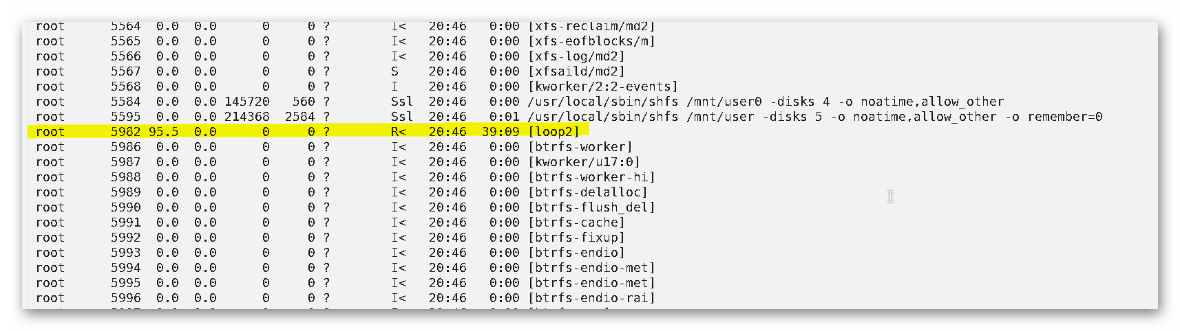

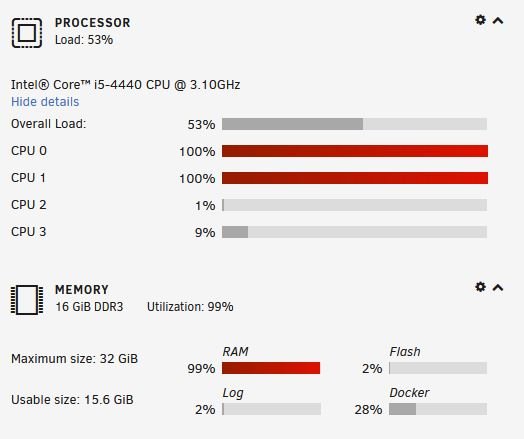

I'm trying to get to the bottom of an issue where unraid seems to get stuck at 100% CPU usage semi-regularly. What's odd is that the unraid main screen shows 100% CPU usage across all cores while the Dynamix System Stats plugin only seems to show 50% usage.

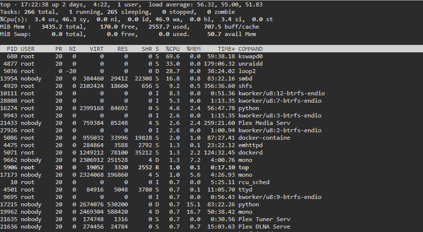

Opening a terminal and running top shows that the CPU usage seems to be coming from 3 main processes: kswapd0, unraidd & loop2.
What are the kswapd0 and loop2 processes? Should they be using this much CPU? Can they be safely killed/restarted?
kswapd0 is the process that manages virtual memory (swap space). Since most Unraid users don't have swap space configured I would expect the process to be pretty idle.
loop2 refers to the mounting of a disk image. In my case it's the docker.img mounted via loop2 on /var/lib/docker so it probably is in your case too.
More worrying than CPU usage spikes up to 100% is your load average (the top line of top) which, unless you have a lot of processor cores (I mean Threadripper or dual Xeons), is excessive and has been for some time. I have a feeling that the problem might be associated with loop2, which is waiting for disk I/O and also has a very low nice value. That might point to corruption of your docker.img. You also have "only" 4 GB RAM and a few docker containers running so you'll be getting quite low on memory. Your diagnostics zip would reveal more.

Yes, you're running out of memory:
Nov  7 21:56:39 Tower kernel: Plex Media Scan invoked oom-killer: gfp_mask=0x6200ca(GFP_HIGHUSER_MOVABLE), nodemask=(null), order=0, oom_score_adj=0
One thing you might want to read is this:
Your syslog is in fact full of OOMs. So try @Frank1940's advice. If that doesn't free up enough RAM you could try running as a plain old NAS without any docker containers running until you can add some more.

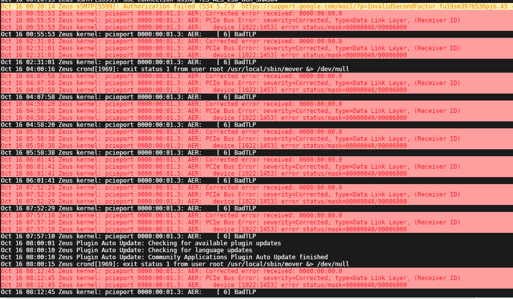

I can see in the logs there are a few erros with a PCIe bus, can someone help with what  the exact issue is?
zeus-diagnostics-20201016-0920.zip
35 minutes ago, xxbigfootxx said:
Same here. I've been noticing the server run quite sluggish and i even installed more RAM into it.
Since all of the errors are with AER and they are all Corrected - it would be safe to disable AER - however, I would not recommend doing so.
Instead, since this issue is being triggered when attempting to access the memory mapped PCI Configuration; I would use the kernel option to switch back to legacy PCI Configuration you can do so by adding the following kernel parameter:
pci=nommconf
This will force the machine to ask the device itself for it's configuration parameters rather than mapping the device's configuration to a memory address. There's a completely negligible performance difference, and this will keep AER enabled, which can improve stability (for example, if an actual error occurs AER might be able to correct it on the fly and not result in a crash)

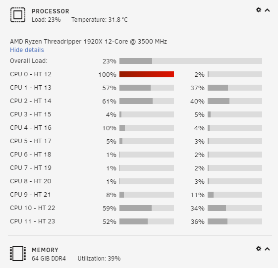

I have the same issue on occasion.  nothing is assigned to use cpu0.
supervisord.log
Edited by DaSlinky
Hello,

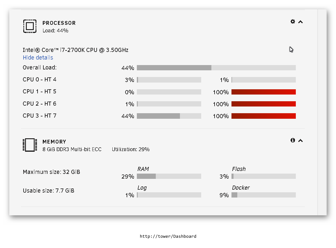

Just to chime in, I am also occasionally having this issue i think. CPU maxes out (not on all cores), docker containers become unresponsive, memory seems to be all used up. I am just doing a reboot when i notice that it's happened. but obviously this is a crappy workaround.
unraid-cpu.JPG.74525d2f5ab8343d15aa3cc404898145.JPGunraid-console.JPG.c22225a8508fe121dfbe5cf82ff34c69.JPG
Does anyone have any working solution?
Cheers!
