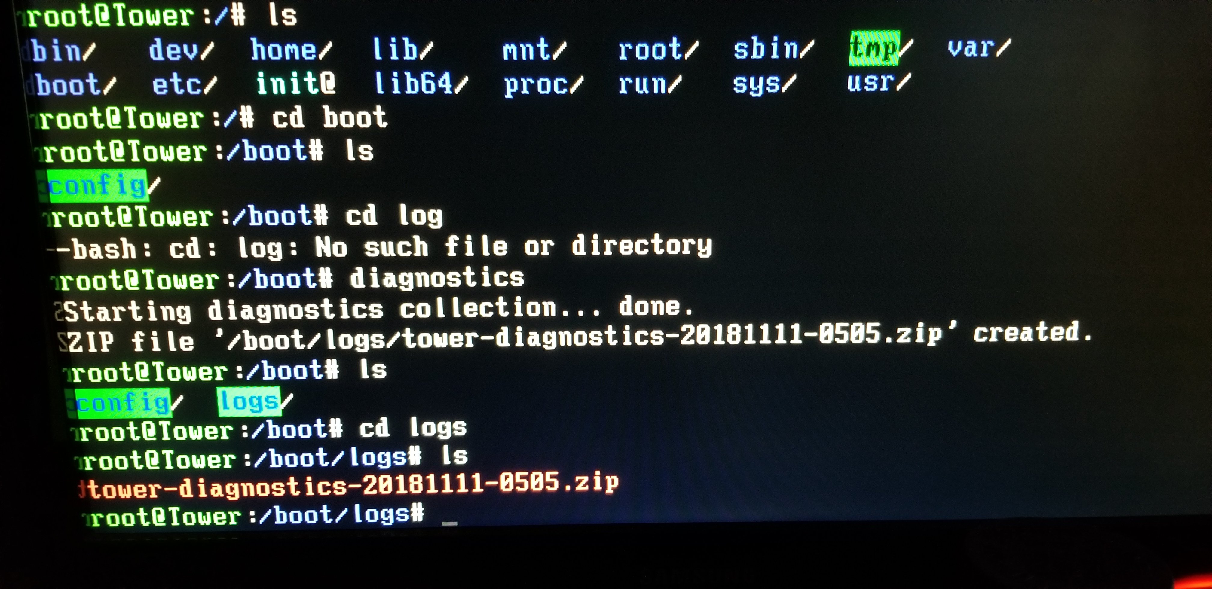

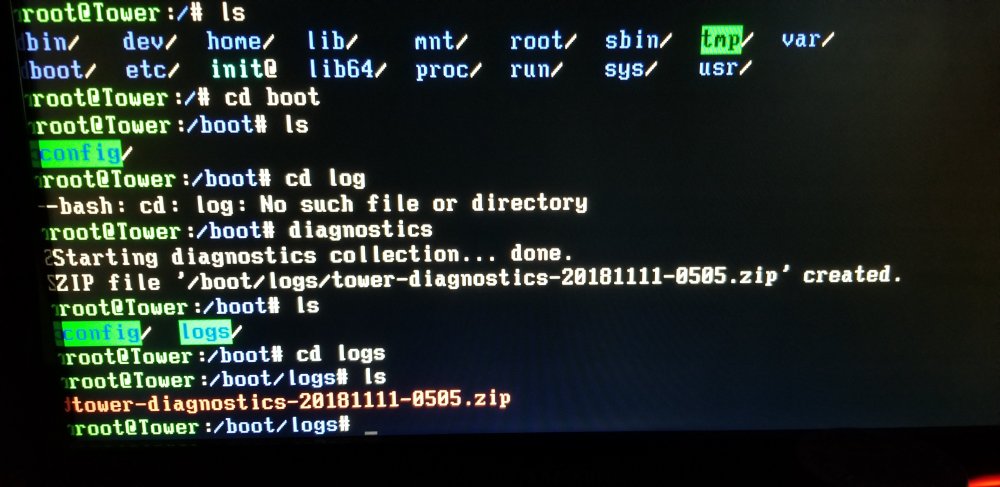

Picture below, logged into Tower, double checked for log folder, ran diagnostics again, and logs folder shows up.
shut down machine, and no log dir.
What am i screwing up?

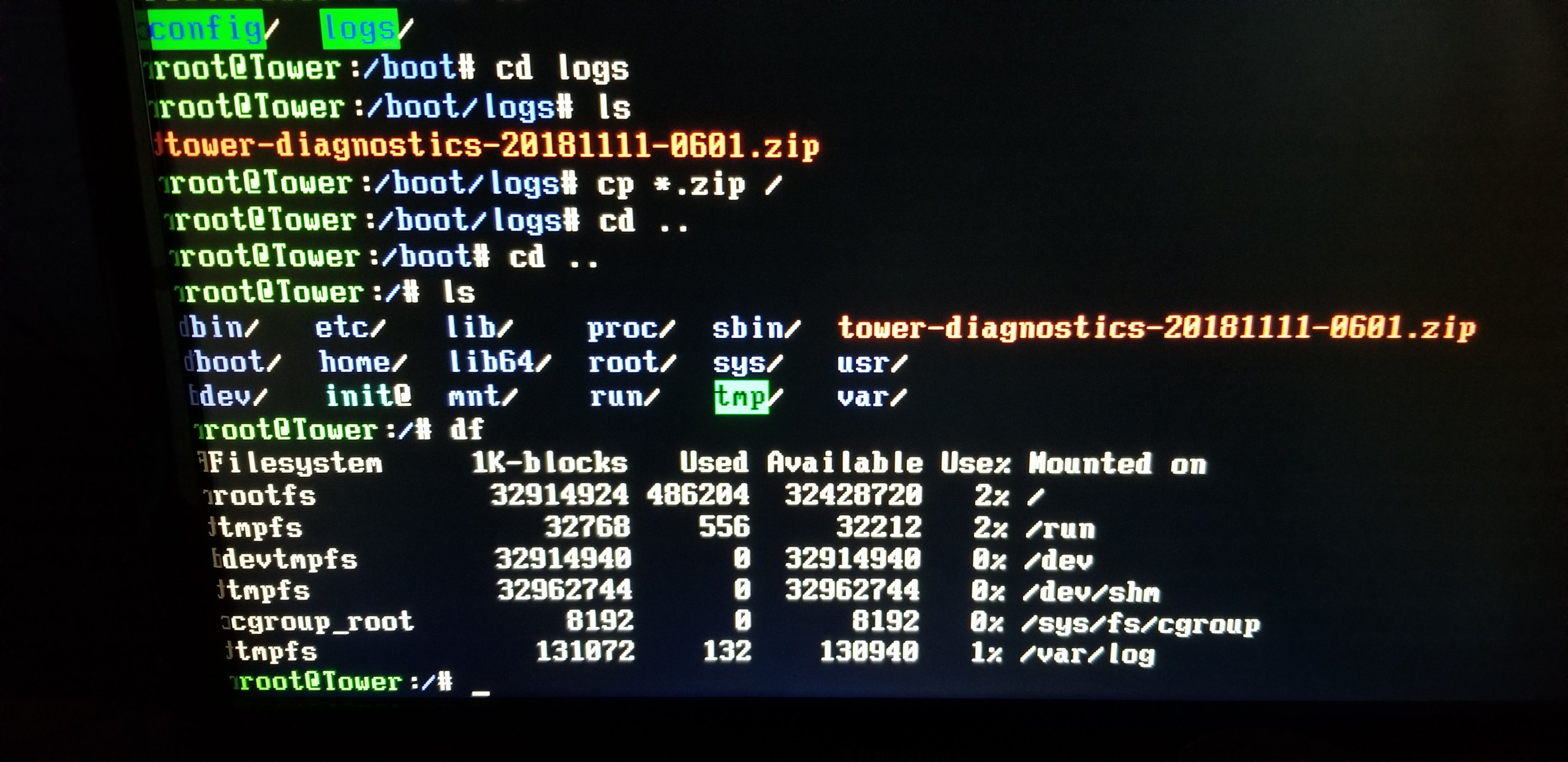

Im on a USB 2.0 port trying another, is there a way to tell ive lost the drive and its writing to ram without shutting the machine down?
If you use the ‘df’ command it will show you what devices are currently mounted.    If /boot is not on the list then the USB drive has dropped offline.

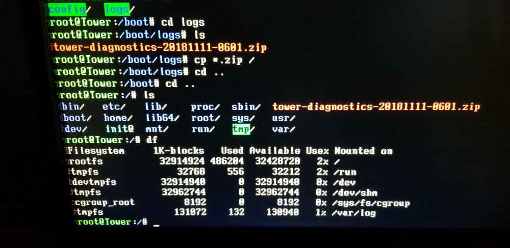

this is what I'm seeing, I tried the 4 front panel USB's ( 2 2.0, 2 3.0 ) and the 4 rear ones and each time the file is not on the thumbdrive when i move it back to the windows PC to open the zip and post it here.  can i just stick in another USB drive and cp the file there?
