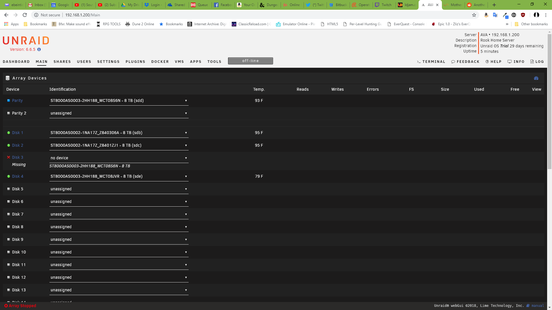

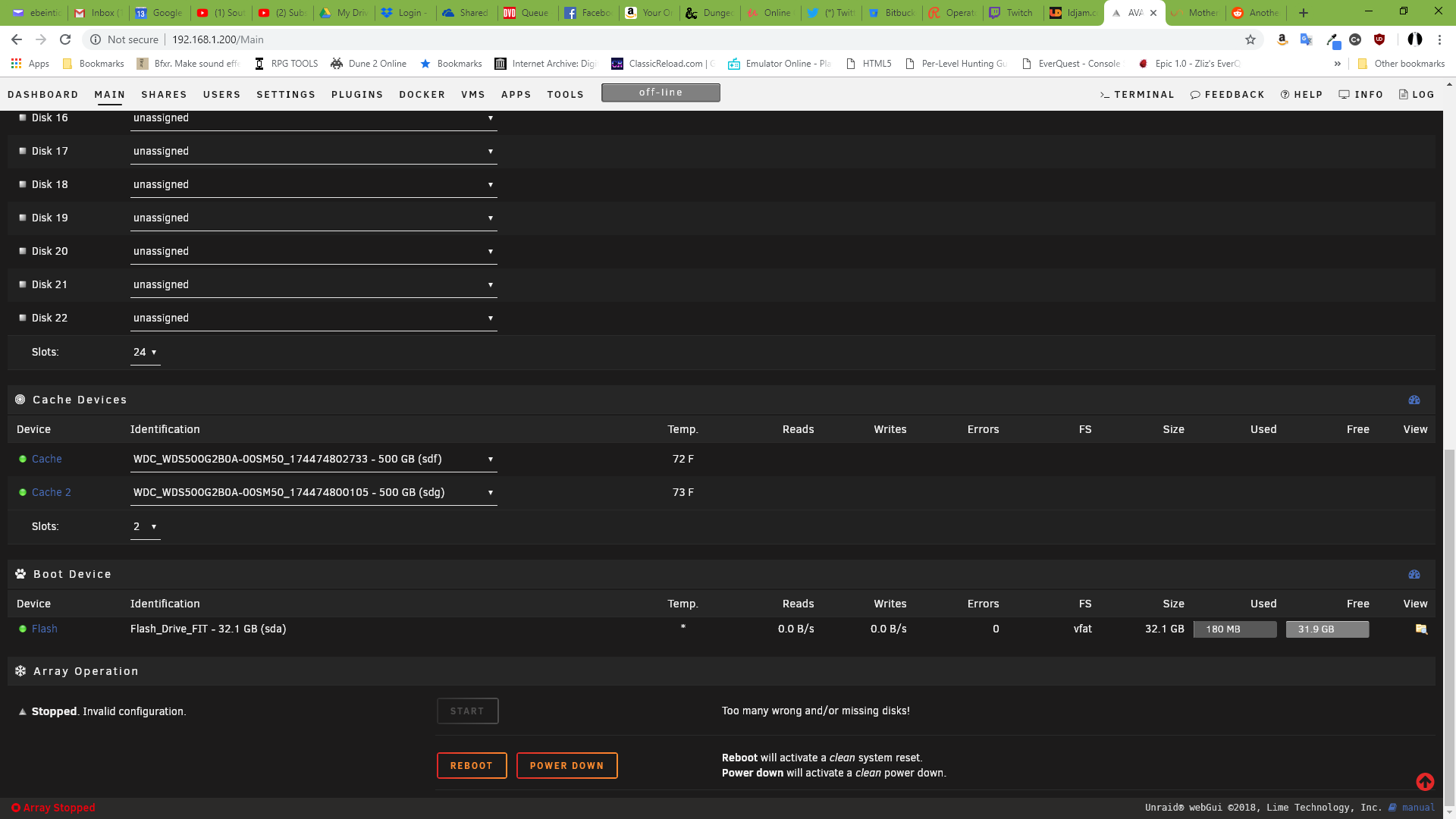

sdd is the parity device ive set it to no device in the array devices, then set it in parity.  though now it says invalid array and wont let me start it.
Edited by Ebein
In your sig you only list 4 storage drives.
The disk you have assigned to parity is the same disk that is missing from disk 3.  You need to select that drive in the position for drive 3, not parity.
I assigned them all as data, to see which drive was unformated, then set it to no device and tried to move it to parity.
