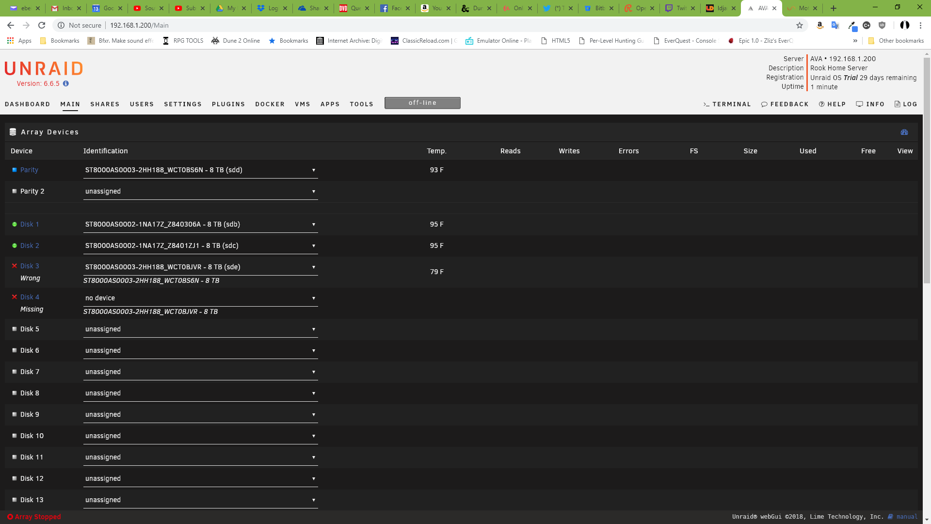

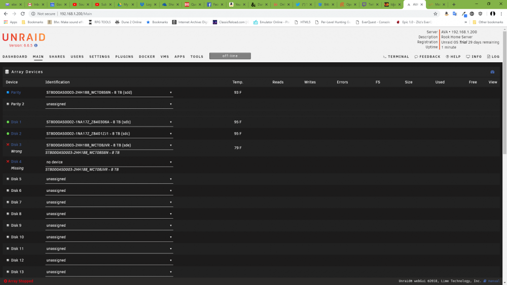

Based on the screen-shot you attached, Unraid is expecting a drive in the #3 slot.
I haven't reduced/expanded the number of data drives in several years so this may have changed...
If you previously had all 4 drives as data, then (I think I remember this correctly) you need to remove from your last data slot (#4 in your case). I don't think you can fill the data slots out of order.
Regardless, I don't think you can have #3 empty and #4 filled.

ok ill give that a try
Ok, just look at your diagnostics file. I see that you had 3 data drives.
I think moving the drive that is in #4 to #3 should work.
No Joy, still giving me a array stopped invalid configuration

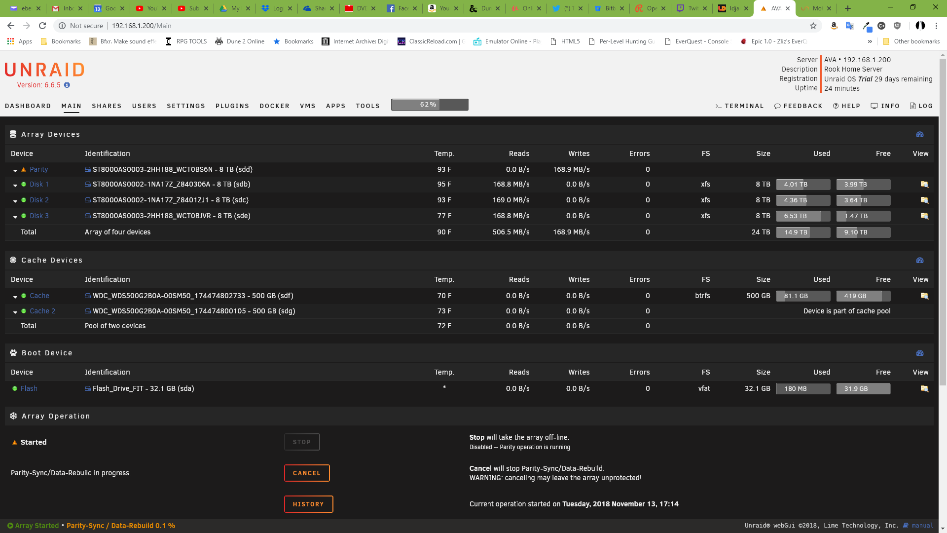

Let's try this.  You now have a picture of how you want the drives assigned  (your screen capture).  Stop the array.   Go to   Tools   >>>  New configuration
Then click Retain current configuration:, then select None, then check Yes I want to do this, click Apply then Done.  Go back to the Main page and verify that all of the disk are assigned to the proper slots. (You use the serial  numbers to do this.)  Now click the Start button.
Fantastic!  Now we are cooking with gas!
For the record, you can have gaps. The problem was that, having done a New Config and tried to start the array, you had committed that new configuration. It was only a test, in order to discover which disk was the parity disk, so doing another New Config with everything in the right place was the correct thing to do.
Thanks for the help everyone, now to let the Parity run for the next 14 hours ;)
