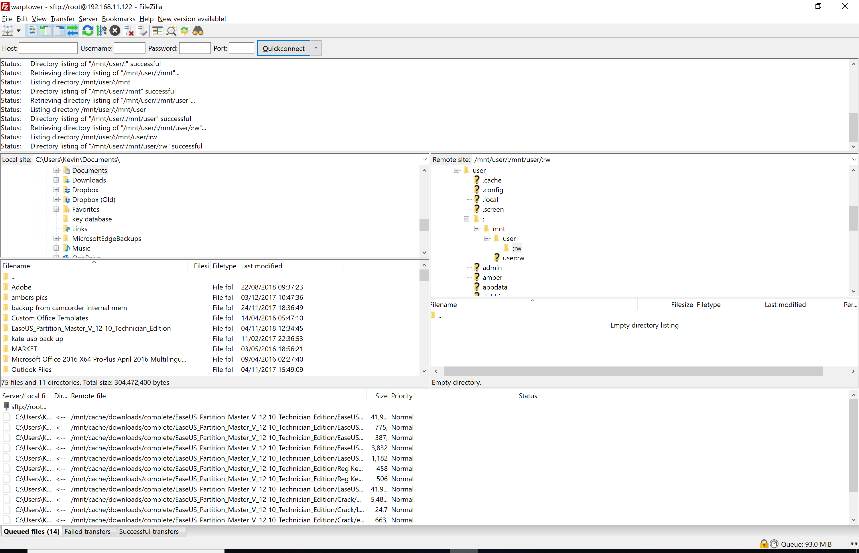

how would i got about trying to rebuild docker image? Thus far, the docker image was deleted anyway when i upgraded the cache, i made a new image and tried to get the dockers back via user defined templates but they return with a command failed error, i tried directly from binhex's repositry to no avail. also there is an error scrolling the log
Edited by loady
Looks like you've somehow managed to create a share called ":"  that's causing those errors
Doing this
mv /mnt/user/: /mnt/user/unknown
Should fix the error and then you can figure out how that ":" folder got created (and look in the unknown share to see what's in it)

Thanks squid, very informative, i never have trouble with unraid to be honest, a reason why i recommend it to people, however, when something does go awry (usually brought on by my own actions) i am not entirely sure where to look, what to do, I did see that that folder too but i wasn't going to delete it in case of thermo nuclear meltdown. I had an odd issue where one of the array disks had become unassigned along the way during the upgrade of ssd, i just identified it and reassigned and UNraid decided to rebuild the whole drive, is that normal ? should there have been a different procedure ?, not to worried except for the fact its a five hour task i have to wait to finish before i can reboot.

1 hour ago, loady said:
Looks like the phanton DIR is empty, i am just going to delete after i follow your instruction above.
After looking at the edited post with the picture, I can tell you that it was created by a typo in one of your docker apps.  If it gets recreated, then check all of your apps for typos

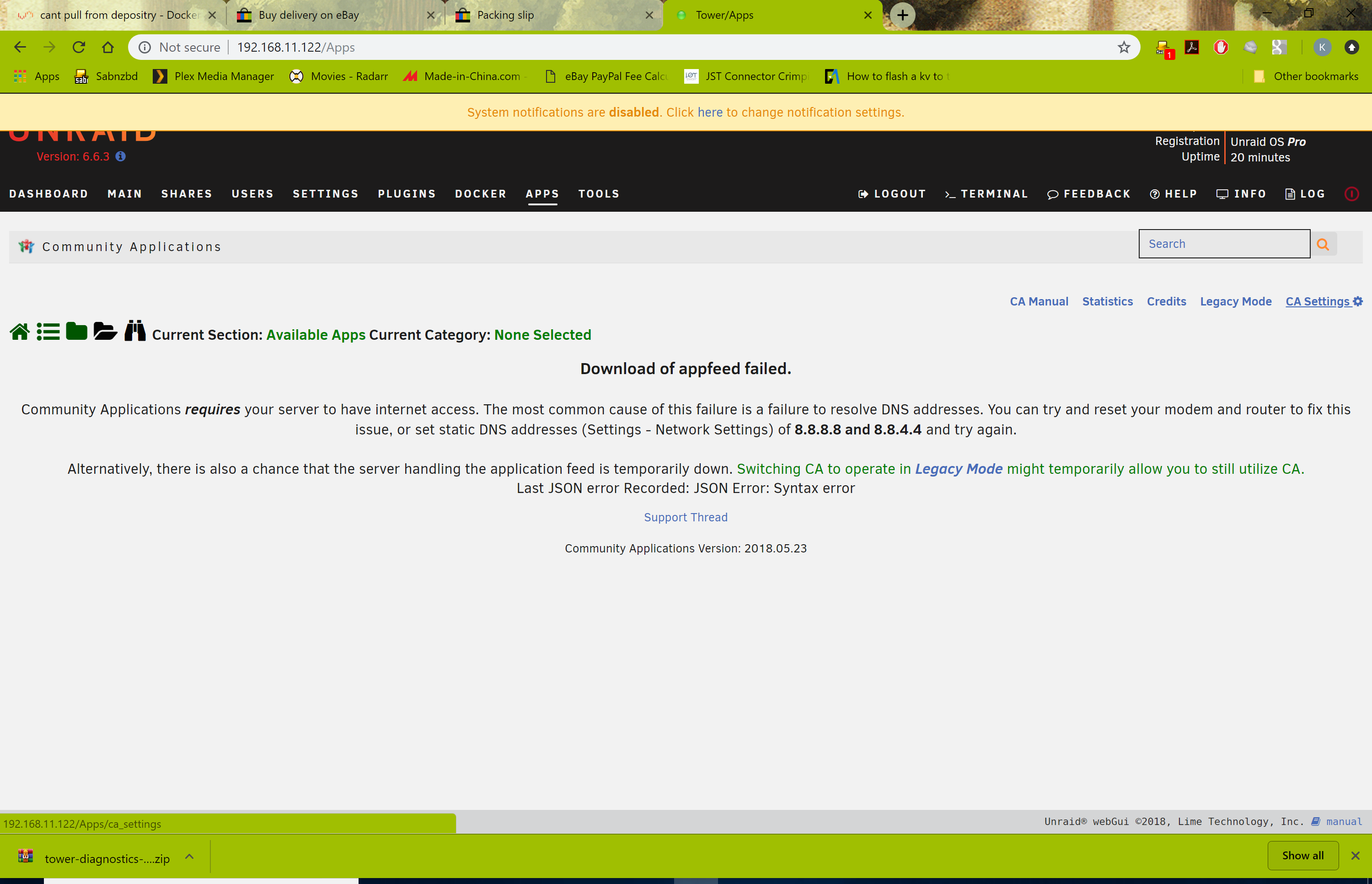

ive just followed your instructions, im onto CA but its not retrieiving anything and the log is spitting reams of error
tower-diagnostics-20181114-0803.zip
Did you reboot after deleting advanced.buttons.plg?
yes
a reboot, not a cold restrart
Close all the browser tabs open to unRaid everywhere.
ok, done
I have internet connection no problem, im connected to the same network as the server, not changed any settings from when it was working
I can tell you that you do need to update CA.  Don't think that's the problem though.
Try resetting the router / switch.
1 minute ago, Squid said:
