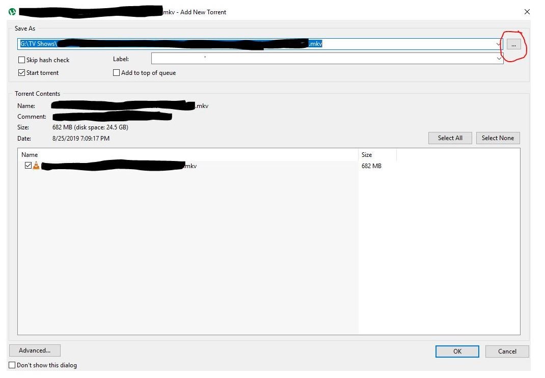

Good Morning All -
Very new to unRaid and in the use of dockers.
I have my array operational and I've installed the binhex-qbittorrentvpn docker without an issue and can download torrents without a problem. (although I do have the VPN portion disabled for testing).
I'm very familiar with using a bittorrent client on a windows platform, but the usage is very different in this environment.
I am used to selecting a magnet link which populates into my client and then I can choose which folder I want each torrent to be downloaded each time, or I can even create a new folder location on the fly.  I normally do not rename items and I want to seed immediately.  In addition, I download directly into my Plex library folders because I want them to show up immediately in Plex as well as maintain seeding.
So that's what I'm used to.
When using the binhex-qbittorrentvpn docker, it appears the download location is set through the initial setup and there is no way to adjust the file location "on the fly" based upon what torrent you may be downloading.
I hope I explained myself well enough.  Am I missing something obvious within the docker usage?
As an example, I've included a screen capture of the dialog box I would normally get for each torrent added to my client (via URL or magnet).

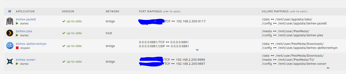

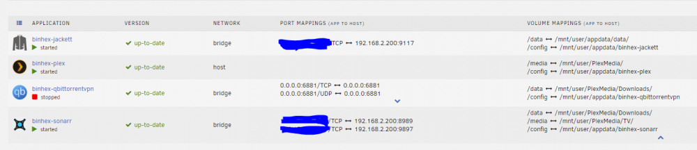

New to unraid. New to a server, but I think I've got it running. Running into a docker issue with Sonarr and Qbitorrent. Seems to be a volume mapping issue, but I can't figure out where the setting is.
Docker settings
I had the above set. But then both qbitorrent and sonarr are looking for the file to be in the config folder?!
(qbitorrent file 'location' and sonarr error message above)
maybe permissions?
Also my qbitorrent causes all my CPUS to pin at 100% now and freeze my server until I stop the qbitorrent docker. Related?
Docker settings
maybe permissions?
Why do you have it configured to save to /config? I don't use these but surely you should configure the applications to save to /data
I don't intentionally have it configured to save to /config. But I've modified my save path to /data/completed (and it lives in /data/incomplete while downloading)
I guess I don't understand how sonarr manages the file locations (while downloading/seeding and then moving to the TV media folder)
There are some great tutorials on YouTube by SpaceInvader1, that will help you understand in general hoiw to set up docker and UnRAID. You definitely dont want your data going in the /config folder.
Check his stuff out.  It helped me a lot when I was new to UnRAID.
