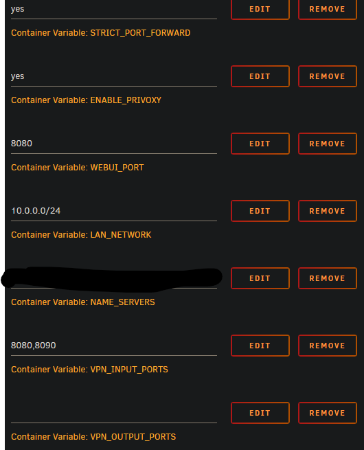

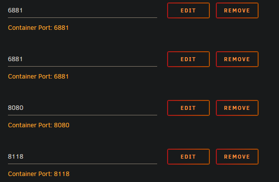

Thank you for responding. Unfortunately I believe my issue is qbittorrentvpn uses 8080 port as well as SABNZBD. In Sab, I removed ports 8080 and 8090. In qbittorrentvpn, I added 8080,8090 as VPN_INPUT_PORTS. I then added a new port, named it 'Sab Port', container 8080 and host 8085. (I left connection as TCP). In qbittorrentvpn already (not me adding), it has port 8080 already.
Qbit ports:
Qbit also has 8080 listed as a WEB_UI.
I tried playing around with the ports, but no success. Any idea?
Edited by LakersFan
