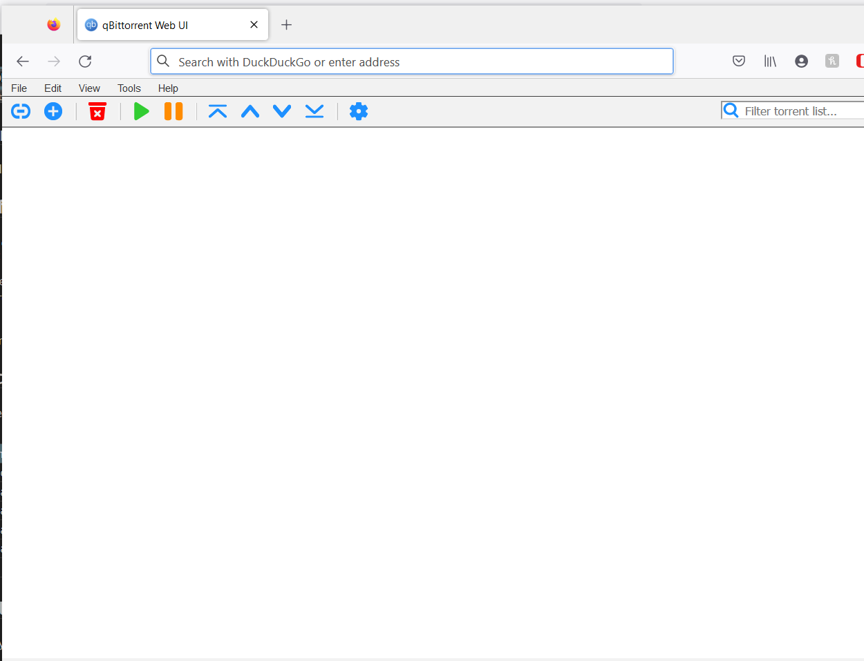

Hi folks.  I'm having a problem where nothing displays in the panes below the menu bar - even if I click on menu bar items, the list does not display into that area.  It's been fine on my home network, but the problem occurs when outside my network.  I'm away from home and can't check the version I'm on, but it auto updates weekly.  I also use SWAG with my own domain at Cloudfare.  I have other containers going through SWAG/Cloudflare without issue.  I also use NZB360 and can verify there are a couple dozen active torrents.
Anyone seen this or know of a fix?

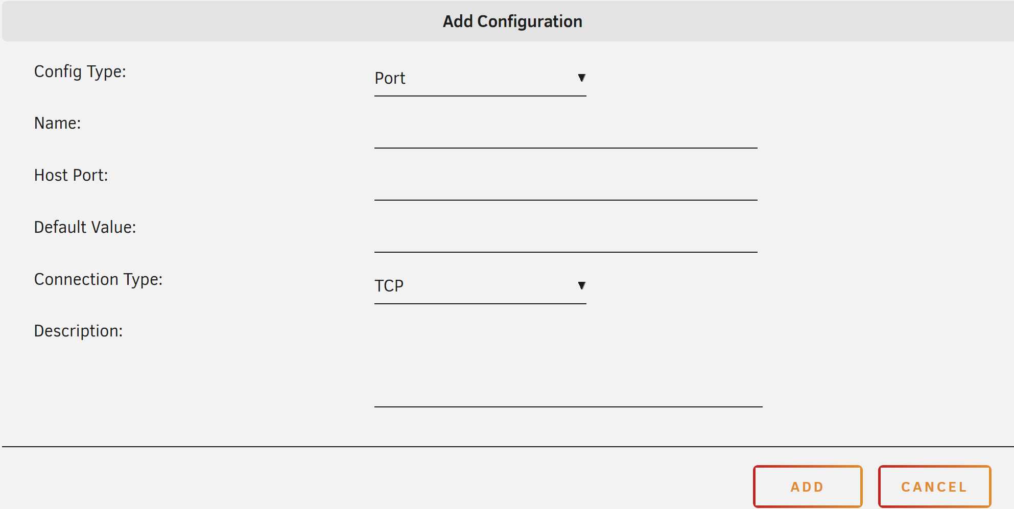

1. Open unRAID Web UI/Docker left click qBittorrent and select Edit
I assume this means binhex-qbittorrentvpn
2.Go to Container Variable: WEBUI_PORT and click on Edit and set the Value to the port number you want to run the Web UI on and click Save
This is NOT "Host Port 3" - which is labelled Container Port: 8080
It IS "Key 9" which is called "Container Variable: WEBUI_PORT" which is also 8080 <- this is the one I changed i.e 1111
3. Find Container Port: 8080 and click on Remove
This is "Host Port 3" - Labelled "Container Port 8080" <- this is removed
4. Click on blue link Add another Path, Port, Variable, Label or Device and select config type of port
ok... no room for intrepretation here..
now the bit I don't get..
5. Set the Container Port: and Host Port: to the same value as the Container Variable: WEBUI_PORT then click on Add
This will be the value I set in step 2. which will be 1111
Ok, I have..
Config Type - Port
Name = What(?)
Host Port = 1111
Default Value = what(?)
Connection Type = TCP
Description = (just a description)
and click add. In my head I've added the host port only. So... do I need to do this again and specify a container port now?
There is no container port (like there was host port) when clicking add another path, port, variable.... and selecting port.
6. Click on Apply at the bottom and wait for the container to be recreated.
yup
7. Attempt access to the qBittorrent Web UI using the new port.
am I right?

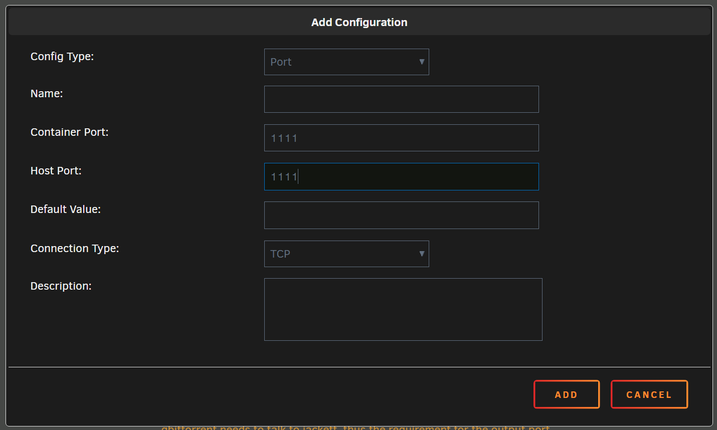

OK I'm confused!, so no 'Container Port:' field?, I've filled it out to demonstrate what it should looks like once configured with your specified port number:-
OMG!
No! No there is not! I now have a setting called Custom Host Port 1111 and in orange underneath it says Container Port:    <blank>
1 minute ago, klippertyk said:
OMG!
what version of unraid are you using?, also try another browser, maybe some adblock script addon is screwing things up for ya.
wait...
If I select the drop down as "path" i see
name
container path
host path
default value
access mode
description
but when i select port - I get what I stated
6.11.5 on chrome. It's basically a new deployment. I'll try edge...
oh my days, there it is....
you know, for someone new, this was really really puzzling. I'll consider myself rather unlucky eh? I'll give it a try.
if its visible in edge and not in chrome then it must be an extension you have installed on chrome that is somehow blocking that field, i use chrome myself so i know chrome and unraid 6.11.5 work with no issues, so it must be an extension.
I would say that is a good theory Binhex yes. I have adblock and ublock origin installed as extensions, but I would have never had guessed that (partly because I had NO IDEA that field was supposed to be there!). A little odd adblock or ublock would take issue with a field to me, but then again, i'm not a code writer either.
