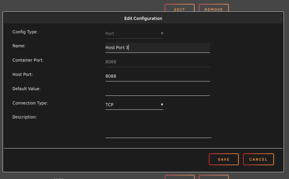

Trying and failing to install this docker (I've used it via PTS and Dockstarter fine with no issues in past and with unRAID appx 2 years ago so not totally ignorant of it)
I've installed with defaults from template, changed the 8080 port to 8088 (why is 8080 default when SABnzbd uses that???) and changed the WEBUI_PORT variable ;-) to 8088 also.
I changed the /data path to my /mnt/user/pool (root data location so I can point downloads to one dir and incomplete to another ONCE I have it running). I made sure I disabled VPN and Privoxy to start (to eliminate them from troubleshooting to start) and click on WebUI which opens http://my.ip.add.ress:8088 which browser says refuses to connect (ERR_Connection_Refused)
Log attached. HTML screen with settings also. Unraid v6.12.4
I'm sure it's something dumb I've missed but brain is much and need some help.I need QBit running alongside SAB so I can tell Prowlarr to sync settings to then allow Sonarr and Radarr to refill all the files I had to delete from previous storage server
Thanks for your time ^_^
Maybe you've already done this but didn't see it mentioned, did you also map host port 8088 to container port 8088?
1744321346_Screenshot2023-09-08at6_20_01PM.thumb.png.3332d8916b5dd4c2da0de991ae8f7496.png
IIRC you'll have to delete the current 8080 mapping because you can't edit it and create a new port mapping.

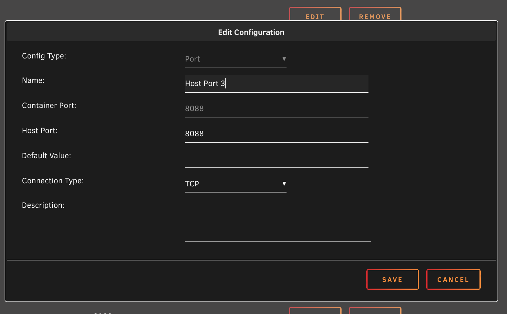

I came up with another option lastnight (move SAB from 8080 to 8081) and then QB works with no VPN enabled. Add my VPN and enable Privoxy and log seems to show no issues but cannot access WebUI - ERR_CONNECTION_TIMED_OUT
