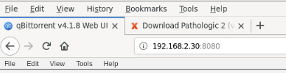

looking at your logs i noticed you havent changed the LAN_NETWORK from the default:-
LAN_NETWORK defined as '192.168.1.0/24'
and looking at your screenshot you are using a different network, so you need to fix this.
if you dont know how to define this correctly then see Q4 from the following link:-

i can see from your screen and your log you havent configured lan_network correctly, this is from your log:-
2019-11-19 02:20:21.317692 [info] LAN_NETWORK defined as '192.168.1.0/24'
and from your screenshot i can see your unraid ip is 192.168.2.13 if you dont know how to configure this correctly then see Q4 from the following link:-
https://github.com/binhex/documentation/blob/master/docker/faq/vpn.md
I've changed "Container Variable: LAN_NETWORK" from 192.168.1.0/24 to 192.168.2.0/24 as my LAN is always at 192.168.2.x.
But still cannot access the webUI, though I get something black while loading at port 8080...
After the black page, I get page not found, as always.
Even port 2020, 6881, 6882 or 8080 doesn't work.

you have changed your webui_port to 2020, taken from the log:-
WEBUI_PORT=2020
if you want to use port 2020 to access the webui then you need to alter the host AND container port from 8080 to 2020, alternatively change WEBUI_PORT from 2020 back to the default of 8080.
Edited by binhex
Thank you, changed the port back to 8080 and it's totally working now!
