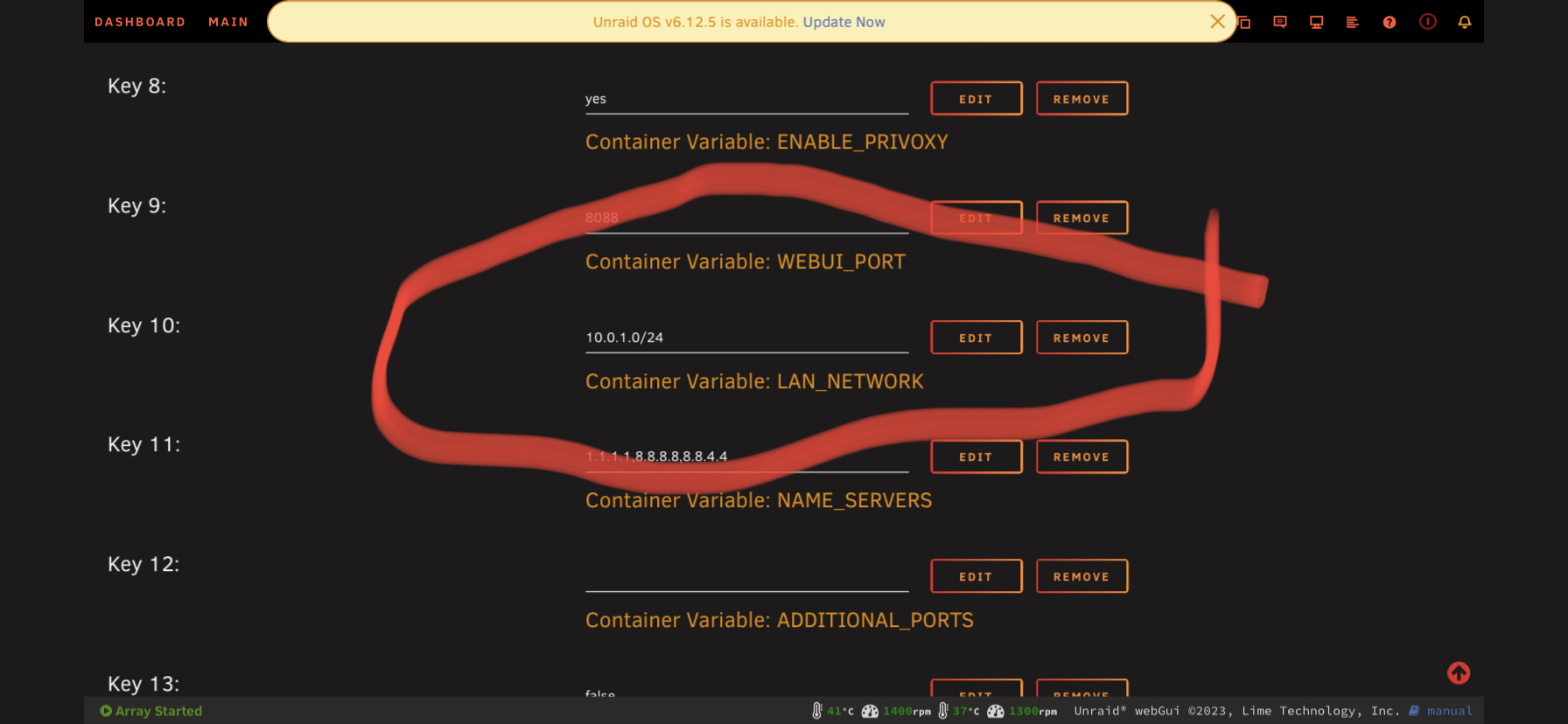

1 hour ago, mlitz123 said:
I am using a VPN to access my network from a remote location and when I try to open the webgui it times out and wont open.
I tried to add a new variable with "unraid network,VPN Network" but that didn't work. Any idea how to fix this?
Rather than adding a new variable you need to add the VPN network to the LAN_NETWORK variable that already exists. Comma separated.IMG_2602.thumb.jpeg.caef9a17affed9dd6468cca95c29c3f3.jpeg
