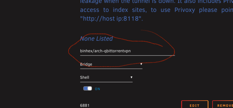

24 minutes ago, Jannik_ said:
where that preferences line is?
Sorry but I’m not sure what you mean by “preferences line”. The repository field is in the docker container configuration.

  • I rolled back to tag 5.1.1-1-01 which fixed the issue for me. I guess the new update wasn't tested for wireguard connections. Edit the docker container and change "Repository" from binhex/arch-qbitt
