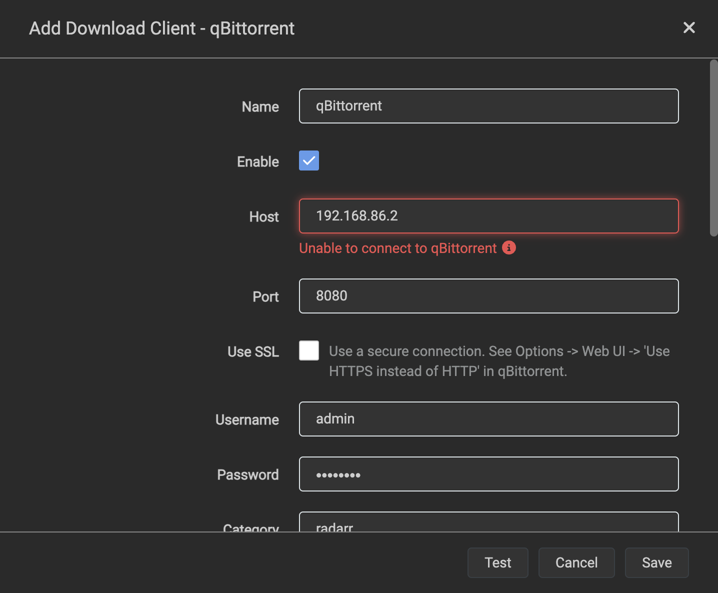

Hey guys, just starting with unraid and have everything set up with binhex (plex, radarr, sonarr, qbittorrentvpn). I got through the qBit password issue just fine but I can't get radarr and sonarr to connect to qBit, am I doing anything wrong on my end?
Thanks in advance!
Try 172.17.0.1
3 hours ago, wgstarks said:
Try 172.17.0.1
Adding this as the host ip for qBit in radarr didn't work, did you mean to put it elsewhere?
Edited by CopesaCola
clarity
