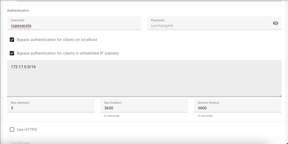

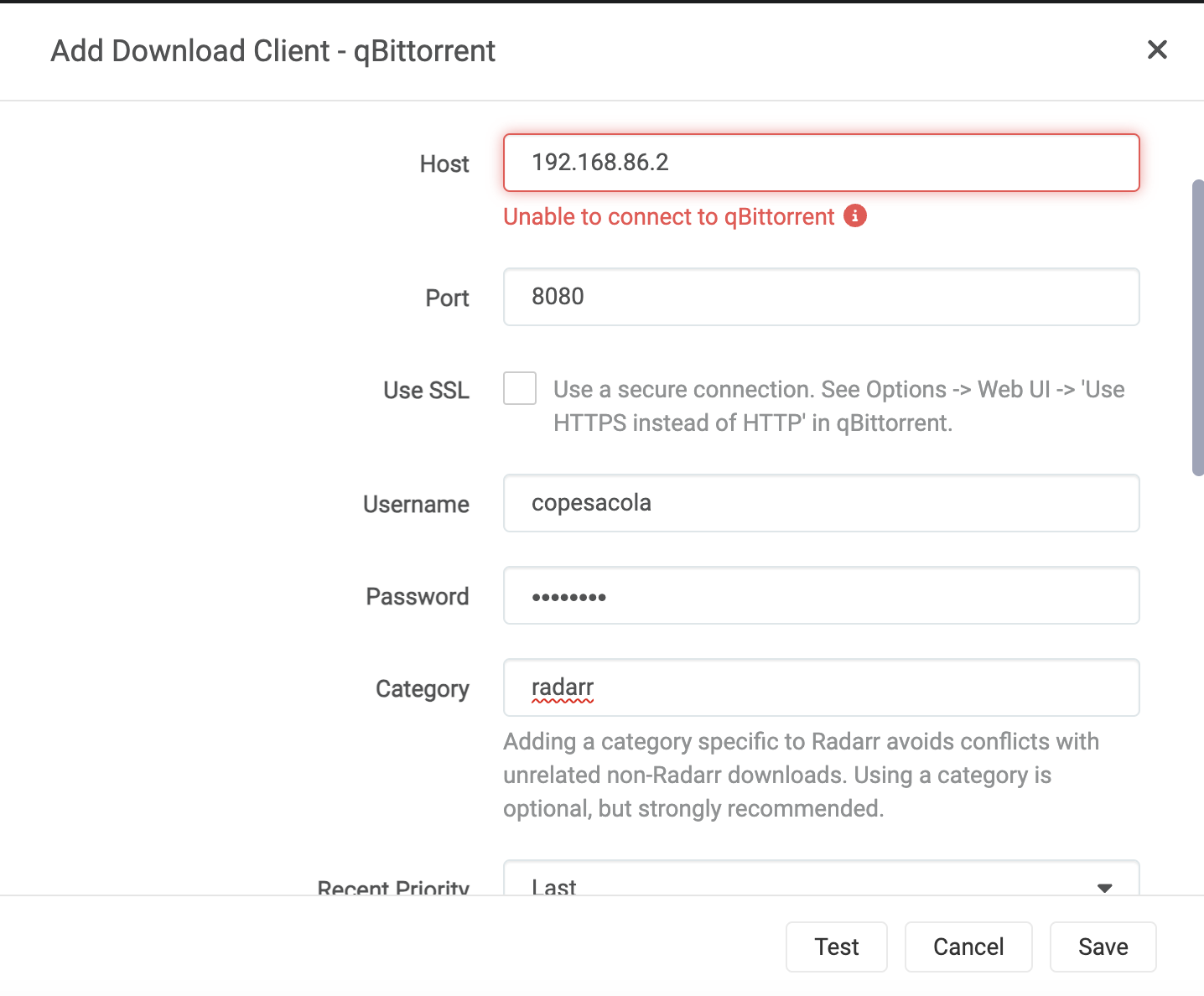

6 hours ago, CopesaCola said:
Adding this as the host ip for qBit in radarr didn't work, did you mean to put it elsewhere?
Another option would be to whitelist connections from your local network.
172.17.0.0/24 is the network assigned to docker0 in my unRAID machine. You can verify yours by checking Settings>Network Settings>Routing Tables.
No dice

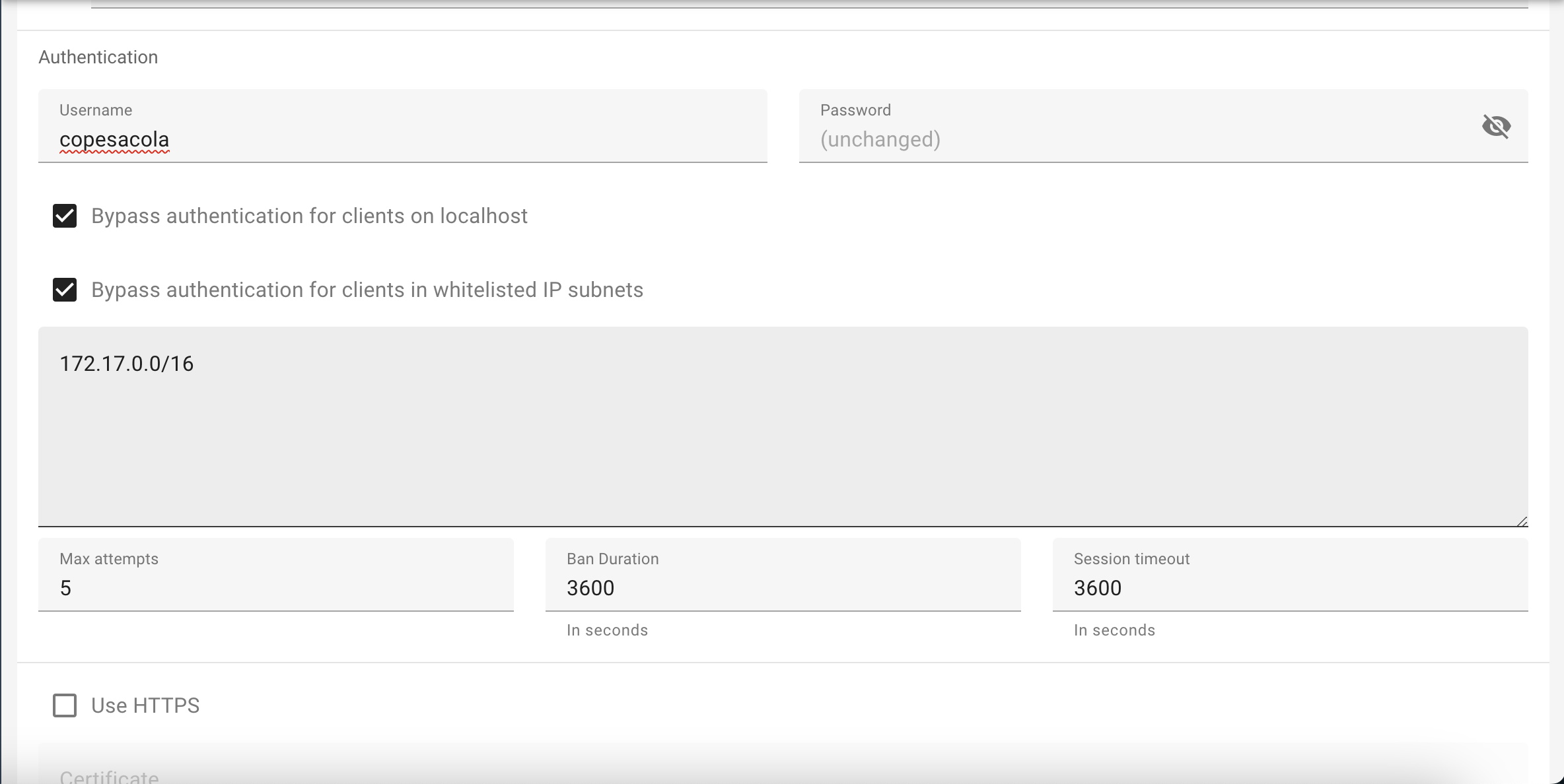

31 minutes ago, CopesaCola said:
No dice
Is that the network assignment being used by docker0 in your routing table? Also, did you change the IP in Radarr/Sonarr to match?
That is the docker0 assignment.
Do you mean changing the host IP in radarr/sonarr to 172? If so that also does not work.
I have the Network Type in the docker settings set to custom: br0 if that matters
I would think it does. You could test that by switching to bridge.
Im sure there’s some way to get this to work with custom networks but I don’t have much experience with them. Perhaps @binhex can help.

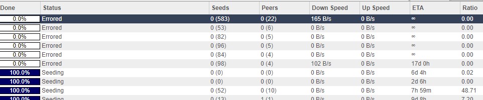

Sometime today, my QBitTorrent started erroring on all new torrents immediately after being added. Torrents that were already finished and seeding are still working fine. I have tried reinstalling, rebooting, and updating to the newest docker container but am still having this issue. Attached are my docker logs. The share still has over 2 TB of empty space.
dockerLog.txt
The log you posted is just the tail of a log but it shows a successful start of the container. I think I would try switching to another port forwarding server and see if performance improves.
EDIT: DISREGARD! My share's minimum free space was set too high, and I was unable to add anything else to it, causing the issue.
Would you be able to go into more detail about how to do that? I tried updating the endpoint in the wg0.conf but was unable to connect after doing so. Please let me know if there is anything else I can provide.
Edited by doshbox
