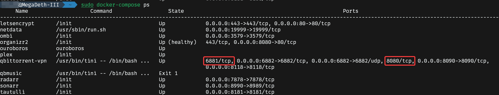

I am attempting to create two containers from this image, (see the reason why on an rTorrentVPN thread), but this seems impossible. No matter what I set the ports to on a container, there are some hard-coded ports that cannot be changed, and it appears as though that's causing conflicts when I attempt to spin up a second container from the same image. Here's the first container's config in docker-compose.yml (note the custom port numbers):
  qbittorrentvpn:
    image: binhex/arch-qbittorrentvpn:4.1.9-1-01
    container_name: qbittorrent-vpn
    network_mode: "containernet"
    privileged: true
    environment:
      - VPN_ENABLED=yes
      - VPN_USER=<NOT SHOWING>
      - VPN_PASS=<NOT SHOWING>
      - VPN_PROV=custom
      - LAN_NETWORK=192.168.100.0/24, 172.18.0.0/16
      - DEBUG=false
      - WEBUI_PORT=8090
      - UMASK=002
      - PUID=1048
      - PGID=65540
    volumes:
      - /volume2/media/dockervolumes/qbittorrent/config:/config
      - /volume2/media:/data
    ports:
      - "6882:6882"
      - "6882:6882/udp"
      - "8090:8090"
      - "8118:8118"
Yet when I create the container, check out the ports that it uses in the attached image. (I highlighted them.) You can also see in that image that the second container did not spin up; it exited with a code of "1".
  1. Are these "hard-coded" ports the culprit of causing the second container to fail to load?
  2. Whether or not #1 is true, what can I do about this?
no, those highlighted ports are the default ports as specified in the dockerfile, this is not the issue.
can you please post the docker-compose file for the second container you are trying to setup so that i can compare the two.
Certainly. Here's the `qbmusic` container:
  qbmusic:
    container_name: qbmusic
    privileged: true
    environment:
      - VPN_ENABLED=yes
      - VPN_USER=<SAME AS ABOVE>
      - VPN_PASS=<SAME AS ABOVE>
      - VPN_PROV=custom
      - DEBUG=false
      - WEBUI_PORT=8091
      - UMASK=002
      - PUID=1048
      - PGID=65540
    volumes:
      - /volume2/media/dockervolumes/qbmusic/config:/config
      - /volume2/media/downloads/music:/data
    ports:
      - "6883:6883"
      - "6883:6883/udp"
      - "8091:8091"
      - "8121:8121"
so the docker-compose file looks ok, i need to get some more logs on that exit code 1 really, try issuing:-
docker logs <name of container>
is there a file /config/supervisord.log file generated?, if so please attach.
Egg on my face. I forgot to copy over all of the necessary OpenVPN files to the config/openvpn/ folder. Thank you for teaching me the `docker logs` command so I could finally see what was causing that exit code.
That was entirely my fault and I apologize for taking up your time with my incompetence.
