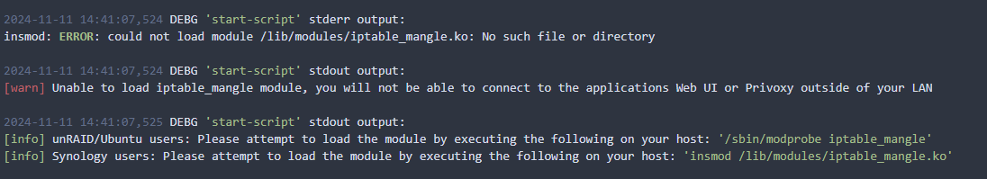

Turns out the problem was just iptable_mangle not loading properly. I followed the documentation on the repo page to fix this and it worked fine. Unsure why it decided to be problematic now after an unclean reboot and not from when I originally updated to the version of unraid that didn't have this option enabled by default anymore, but its fixed now.

After setting the debug variable to true for the docker contain I got the attached in my logs.
running the below in the unraid server terminal fixed the issue
/sbin/modprobe iptable_mangle

Many thanks. I located the same in my supervisord.log, tried the command, but got the following error (and the WEBUI is still inaccessible):
modprobe: FATAL: Module iptable_mangle not found in directory /lib/modules/6.1.106-Unraid
That seems to reference a very old version of Unraid. Is that where qbittorrent should be looking for the iptable_mangle module ? Is there another way to create the module and force load it at startup?
I have found some other people with similar issues for Deluge, etc. and will continue troubleshooting. If anybody has guidance, I'm all ears.
I think you have tried running the command in qbittorrent console and not the unraid server console as I got the same error message when entering the command there
You want to run the command in the terminal that opens when you click this icon
